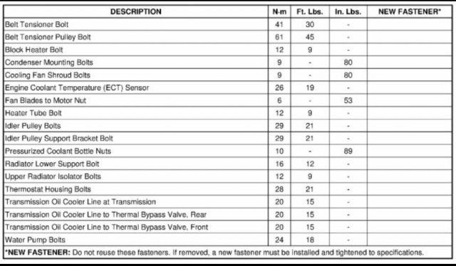

Anyone have the torque specs on these pulleys? I'm thinking 21-22 ftlbs. I remember seeing or hearing that on some of the vids but I'm not 100% sure.

Great looking pieces. I'll install in the morning. Found this tq spec sheet too.

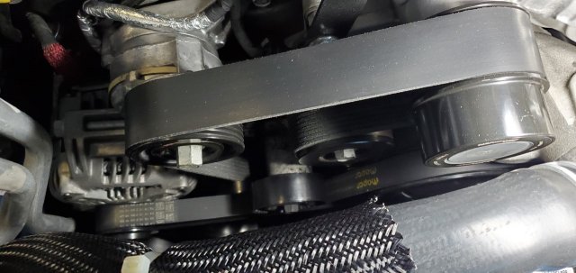

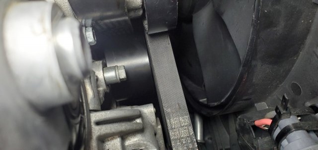

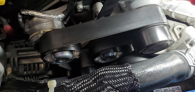

So the fun begins...wasn't too bad actually. Just a bit tight with both idler pulleys and not able to get my hex bit socket/tq wrench in there with the fan shroud. Relied on 38 year inner tq wrench...lol
No issues with adding Metco lower idler pulley. Seems to be same as the upper idler. A bit closer to the accessory belt but everything else seems fine.
Before and after...

So the fun begins...wasn't too bad actually. Just a bit tight and not able to get my hex bit socket/tq wrench in there with the fan shroud. Relied on 38 year inner tq wrench...lol
Before and after...
Looks good. So you left the tensioner pulley stock?
No...tensioner and both idler pulleys swapped. See in 1st pic the 3 pulleys laid out. The before and after pic shows the difference in the OEM and Metco tensioner pulley.
Got yah. It was just hard to see the grooves on the metco tensioner pulley on my phone..

Are they the same size as oem? Does that mean the lower idler is bigger giving more wrap on the crank pulley?
Same diameter as OEM so no additional belt wrap. Slightly wider but that's it.
