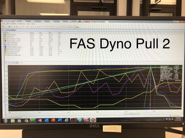

@16GoManGoHC2 you don't show timing advance in your posted logs, how much is it? What was different on the dyno pulls going from 806 to 856?
Winter blend Shell 93 I had to drop my timing down to 10 deg at max aircharge ~1800mg (about 17.5psi). During summer months on summer blend Shell 93 I had it set to 12 deg.

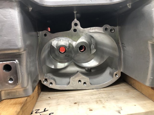

Added FAS inlet plate to my blower, netted 50 Hp gain, unfortunately it cost me my original blower as the plates are flawed and FAS won’t admit to fault, claims installation error. I just bought another plate, their bearing bores are .003” tighter then they should be. Come to find out I’m not the only one that got one like this.
See this thread on the other site
https://www.hellcat.org/threads/warning-with-fas-billet-bearing-plate.240938/
Yes, pulled plugs, very minimal residue, dropped exhaust too, minimal in there too.
0AC41EA8-853F-4655-8A9D-658006812C5F.jpeg 568EEB98-4D81-4DAD-8019-1965362A92E8.jpeg
@Speedy!
Sorry, I couldn’t figure out how to find what you asked for before, is this it??
