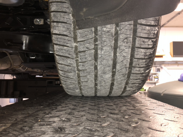

What is amazing is he has rubber remaining on those tires! I have seen pictures.
DGatzby,
You are right to observe those stock Pirelli 305 All-Season tires are tough mutha's. I get to drive 30 minute sessions with 10/10th's Motorsports...so let's see...let me borrow your trusty slide rule here...21 sessions at three weekends under my belt...that's 10.5 hours of hard-charging HPDE, plus about 2,500 street miles.
Putnam Park October 17, 2020 - great weather for tracking! Got a ride in that gray Grand Sport with the instructor owner.
Had my alignment with the AAD suspension parts (and Whiteline rear cradle bushings) shot after installation and again after my National Corvette Museum HPDE on October 3/4. They remained very close on front and rear camber - only changed .1 degree one way or the other which is almost within the alignment machine's/operator's tolerance, but note how the front and rear toe got more positive (front of the wheel pointing in more for those unfamiliar with the terminology of alignments). I invite everyone to speculate (or if they are knowledgeable) about why this would happen. I didn't change anything after the second shoot and ran it with less than ideal positive toe - it wasn't terribly off - and I'm going to change the tabs here and there and then get it all perfectly set. The "Current Measurements" with color is right after installation shoot, and the other one is the after NCM shoot values.
For those of you considering buying the adjustable AAD Performance control arms, DGatzby and I may be the forum members with the most recent experience with them. DGatzby hasn't gotten responses from the owners (I believe there are three guys) to his specific questions. I had an informative back and forth with both Parker and Zach (Zach uses their suspension parts in autocross and road course in his Charger - the parts fit Challengers, Chargers and the Chrysler 300 ) over about two months - pleading supreme ignorance while trying to fully understand how their tab system works and to translate it to my road course application (versus their default drag strip/lowered car customers). Parker told me historically less than about 3% of their customers want to set their cars up with more negative camber than stock for road course driving. As DGatzby has discovered Hellcats (RE and probably non-RE) do not realize a net benefit from more than stock negative camber - and especially with his 345/30-20 rear tires on 12" custom wheels he has concluded zero to .5 negative camber - a narrow nearly flat camber window - is the only value that allows his tires to consistently hook. With a nod to Skip Barber's book "Going Faster" I now understand why DGatzby wants hooking out of corners more than camber-enhanced traction. Accelerating out of the corner's apex shaves seconds off lap times - a speed gain tradeoff more than carrying another mph or two into the corner. And safer too because spinning tires and losing traction out of fast corners ain't a good thing! From the photos below, helped by my dusty country lane coming home Sunday, you can see the inner shoulders of my tires are wearing more than the outside shoulder. The grooves are progressively smaller going inward - easy to feel with your fingers. True of all four wheels. Of note for anyone considering HPDE with stock suspension parts and/or stock alighment settings is that last year, with all four tires set at 30 psi cold before tracking, these Pirelli All-Seasons wore evenly. After 1,800 street miles and 4 hours of HPDE at NCM they looked almost new. Only after trying the above negative camber values (day one and two at NCM set at 30 psi, day one at Putnam Park at 32 psi, day two at 30 psi) have I seen the inner shoulder wear - and it slants as expected from more tread outside to less tread inside. Each track is a 200 mile drive from my home each way too. The car handled significantly better with more negative camber, but like DGatzy I found my rear tires spin much more easily under acceleration with negative camber - and the "bad wear" negative camber isn't required. I coudn't hit it at the appropriate point coming out of corners for fear of losing it. I will therefore reduce rear camber to target DGatzby's flat to maybe .5 negative, which is less than stock and much more in line with desired drag strip values. I'll even up the front camber at negative 1.7 - a compromise for track and street. I have ordered triumpforged.com 12" rear wheels and the same size rear tire sizes as DGatzby, but with Michelin Pilot Cup 4S tires instead of his Cup 2's. 4S's will wear longer and my driving skills are not up to getting the most out of Cup 2's yet anyway.
Right rear tire.
Right front tire - the left side tires are are a mirror of the right side so I won't upload photos of the left side. It's not horrible inner wear, but a softer rubber compound would surely have worn even more. I am actually surprised the hard cornering during these two weekend October HPDE events didn't even out the wear pattern. Not cornering hard enough? And maybe I should have started with 28 psi cold to get the tires to roll over a bit more onto their outside shoulders?
Now, about changing those control arm tabs! I defer to DGatzby to illuminate anyone interested in how that process goes. He has prepped me for something of a personal struggle. I'm a Novice Class HPDE participant, but an even more Novice Class Mechanic and under no illusions. But the good news is I now have time after retirement and I'm looking forward to learning to change tabs and then having a shop reshoot alignments. Here's something to think about if you find yourself in the same boat as DGatzby and me working out adjustable suspensions - find a Tire Discounters. My local one newly opened and has the Hunter Alignment machines - wide enough ramps to load up a dually truck's rear wheels - and they offer an unlimited alignment for a year deal (and I think even three years) for a darn reasonable cost over a single alignment. I told the service manager I might be coming in every week with RDEYE because I'm experimenting with adjustable camber and toe and he said that was fine with him. The AAD guys have offered to help me out on the phone too. I'm a note-taker when I talk on the phone, and I have Parker and Zach's informative emails. I plan to regurgitate a "layman's guide to AAD tabs" which for newbies like me would shed more light on how they change camber and toe values for tracking. I'll try and get Parker's blessing to ensure I haven't misrepresented or misunderstood anything. I'll post an announcement on the forum when I get my tab system opus finished and will be happy to send it to any fellow forumite interested.
Last photo of RDEYE before she becomes stranded up on my lift for eternity *grin*. I've recently gotten two sliding jacks so I can lift the car up evenly and take off all four tires at the same time. Ask me about nightmare scenarios my overactive imagination has envisioned. The three worst being it falls off the jack points while I move the lift up and down (probably a very bad idea), an earthquake strikes Cincinnati and it falls off the jack points, and one or both jacks somehow malfunction necessitating removing the garage roof and bringing in a crane to lift the car up and out.
Best,
Finface
