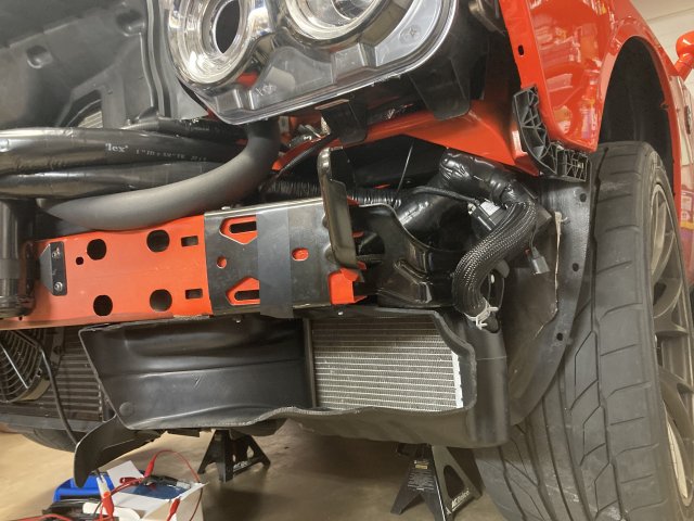

I didn’t realize you moved yours to the front of the bumper
The FI HX was too big to go under the headlight where the KC unit was, had no choice. The FI unit is twice the size of the KC unit. The 140 oz hopper tank is still under the passenger side headlight. I can have those made too if anyone is interested but their pretty expensive anymore, labor and materials have gone up 25-30% in the last 4 years, wonder why 🤔

Are you still using the air box with the intake, or did you have to remove it for the FI refrigerant lines?
No, Whipple air box and intake tube from head light still fit. Can’t really even tell there’s a chiller hiding under there. See filter and air box in there?
