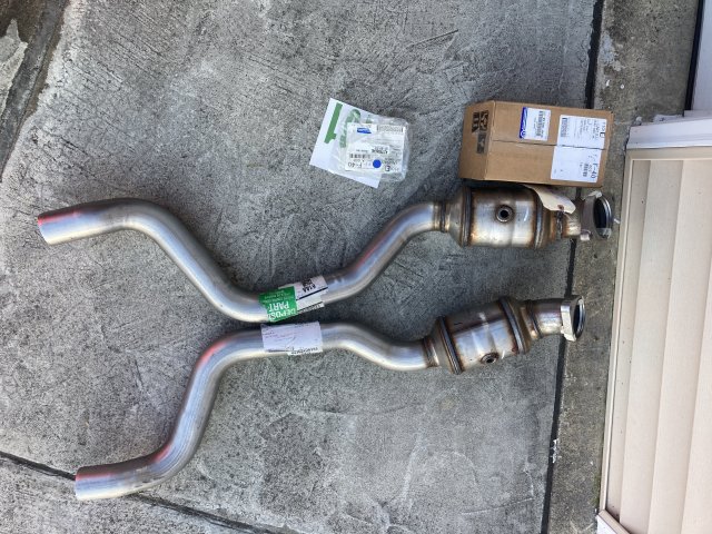

My recall cats are in the attic, they went in the trunk not on the car. I just put new cats on after my engine rebuild so I had my original cats to trade in. I brought my stock untouched pcm with me, they removed my tuned pcm, installed my original pcm, flashed it, and put the tuned one back in, never lifted my car. I also brought my 4 original O2 sensors (MMT fouled) and the goody box with 4 new sensors and manifold studs went in the trunk with the cats. The new cats look exactly the same as the old cats, even the honeycomb looked the same. They do have allot of stickers on them, I’d remove them before using them if I ever use these. 75AA7593-95F6-4731-9F48-C6AF314A561D.jpeg FC855C98-D4B2-4894-94AF-1EAA1616A14A.jpeg C28EDA51-3BEF-4F15-A1BE-6090927112BC.jpeg 0C621501-B7ED-457A-93B1-41539B062DD2.jpeg 64E62B03-1096-40B4-A500-5CD88D67F29A.jpeg
Looks like Xmas. Yee Haaa.
