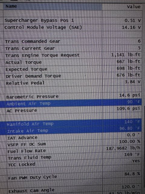

I’m not pulling spark because of IATs anymore on a 90 degree day with the 2.69. It would pull several degrees at the top end before it

Nice, mine with stock blower 2.69 no aux tank and chiller was ending at 96 on a 90 degree day, I believe that was my hot lap as well. The big killer is manifold air temp

and here’s the big difference for chiller vs non. No chiller, MAT was 172 - 2+ degrees of spark pulled for the top end of the track. With the chiller, MAT was 144, no spark pulled
