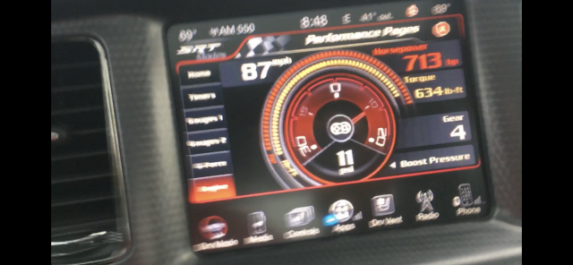

I only saw 11psi on my gauge and in excess of 700hp one time, and it was 41*F… and the snow tires I was on were not happy about it.
I never really thought there was anything wrong with the car, there was never any excessive belt residue if it was slipping, and I ran a 10.9 at almost 5000lbs of race weight in positive DA.
Saying all of that to say that the gauge works, but I wouldn’t rely on it for much of anything. Track times and logs are the best indicators that something is different. If it’s noticeably sluggish… without a CEL the dealer won’t do anything for you other than happily joyride the piss out of your car to see if they feel the same way.
2nd gear comes and goes too quickly… try 3rd or 4th and let her build up some steam. For this pull I let the car downshift from 5th to 3rd and then into 4th… that all happened in about 1 second.

Bad fuel. It must take a while for the car to "reset" it self. Ma has been dailey driving to School this week since I traded her R/T for the 12v diesel. We took her out today( when I found reverse) and I noticed the 50hp right away gauge showed 696 boost was 10psi
4,381
10,904
If Ltkr happened then it would take a long time to get rid of those. Also these tanks are hard to get all of the fuel out with the way the tanks are.
