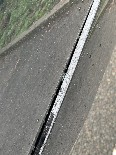

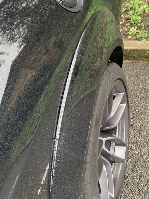

Noticed today one of the rear arch clips has popped off (nothing has hit it).
It was raining so I didn't fiddle with it and wondering what the best technique might be and better to ask before giving it a thump.
Thanks

Thump is appropriate. The rear flares install with clips only.

So did a fair bit of thumping, went back a bit but not fully. Called in local body shop to see what they thought, they had a go and no joy. Decided might be best to take it off and refit whole thing with some some new clips at the ready.

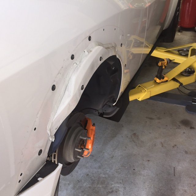

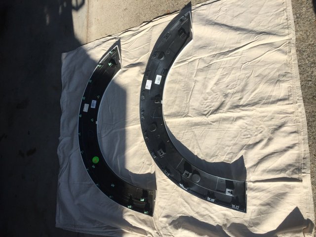

Best pics I have of the rear flares.
That's really helpful thanks very much (y)
