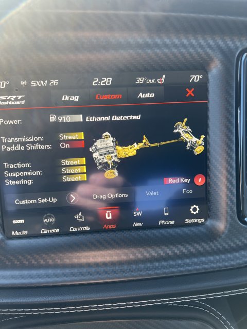

Walland
23 Challenger Demon 170
I went for a little ride today 37 but beautiful blue skies.
