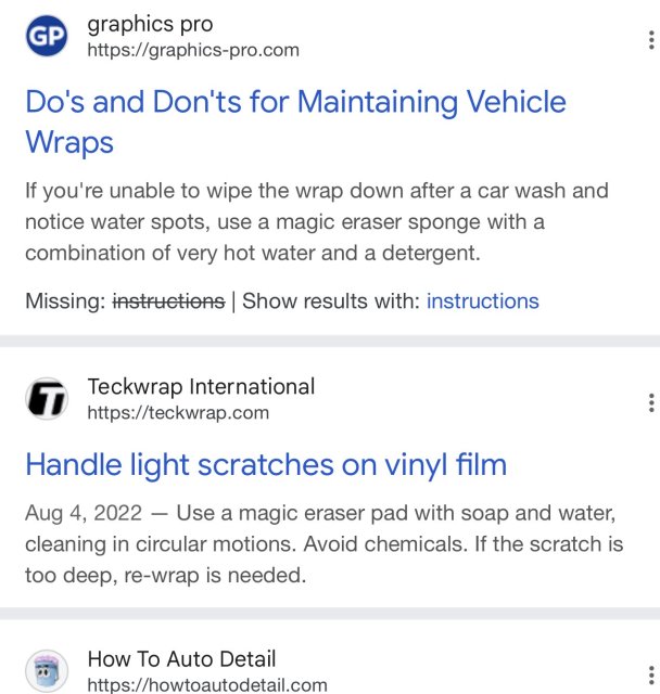

I did some searching on the magic Erasers.
🤣 Oh boy, Magic Erasers are like the wild card of cleaning tools—miraculous on grime, but savage on finishes. Some of the “don’t even think about it” warnings people share are downright hilarious (and a little terrifying).
Here's some good advice for you guys :ROFLMAO::ROFLMAO::ROFLMAO::ROFLMAO::ROFLMAO::ROFLMAO::ROFLMAO:
"Don't clean your genitals with it ever! Unless you're trying to do selfie gender reassignment. Even then, I'd advise going to a licensed doctor who has a little experience in that field."

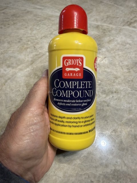

Simple and the accepted proper way. I do not know shit about anything called “magic”. Forget-about-it.
Clay it. That WILL remove the water spots. Then you need to treat it and protect it.
After the clay use this.
Then it does not matter but at your choice then apply a wax or protection layer of your choice. Regular, ceramic, whatever but get a coat of protection on it.
Whatever you do to the water at home quit using whatever spotted it. That can be minimized by wiping the car off quickly and completely after a wash, period, no exceptions to that rule no matter what water you use.
