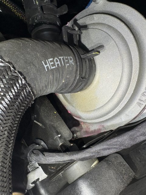

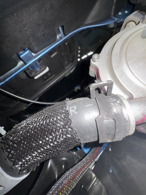

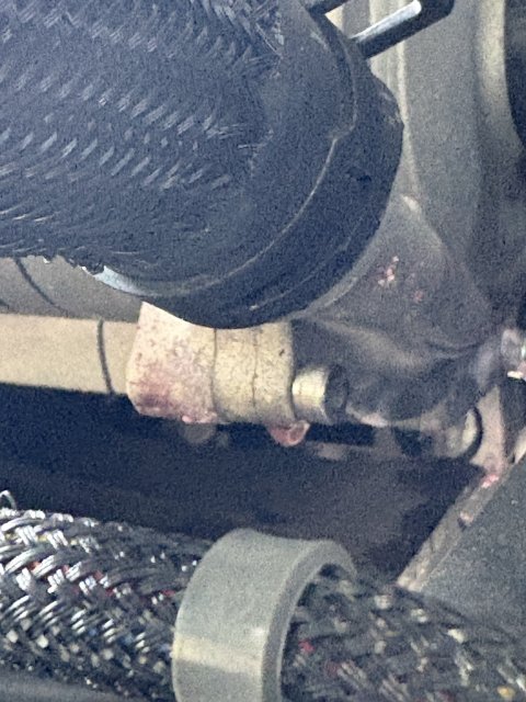

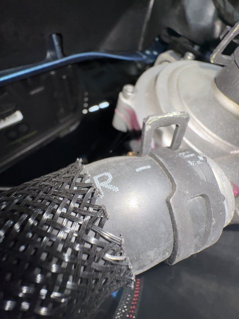

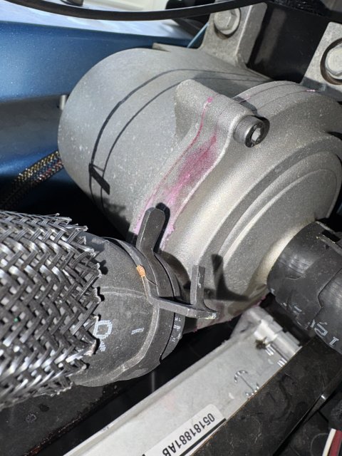

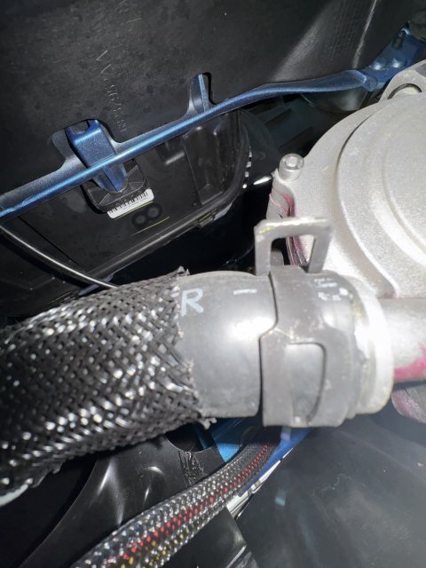

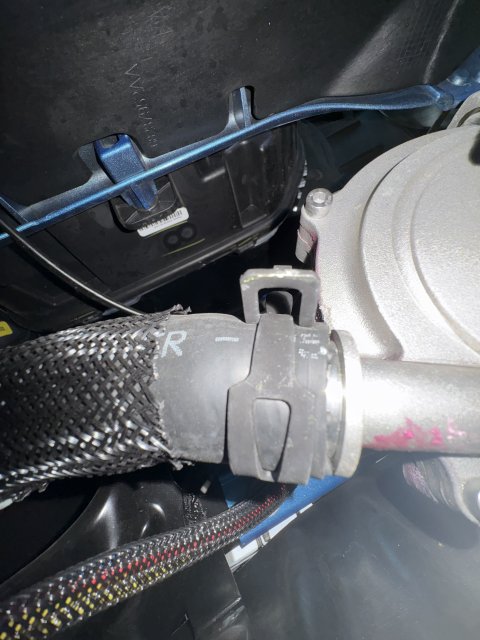

UPDATE!!! Do you guys think this is a supercharger coolant pump leak?
2,666
7,333
Seems to me. How shitty a job? Any direction where I should start would be a great help. Car is a ‘15 Challenger with 7.2k miles. 🤬. Thanks as always.

Thanks Bull, seemingly so. If it’s not just a hose or clamp. I understand pumps are hard to come by, and expensive. Got to do a search on R&R of the front clip as well as pump replacement options. Ugh…

Start with the easy-to-fix solutions, like re-torquing bolts. Then spray it all down with soap, rinse and watch carefully. Maybe a hose is dried out and lost its seal. Be patient, a few drops lost is no big deal. Take your time and isolate the leak.
Years ago my Wrangler TJ was dripping oil from the rear top, maybe a valve cover gasket. Luckily I first retorqued all the valve cover bolts, and several were loose. After tightening the prob disappeared!

I think I’d start by moving that clamp off the hose and putting a worm clamp in its place good and tight.

Do the easiest thing first!

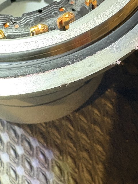

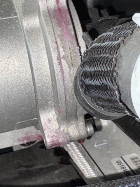

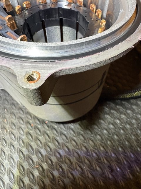

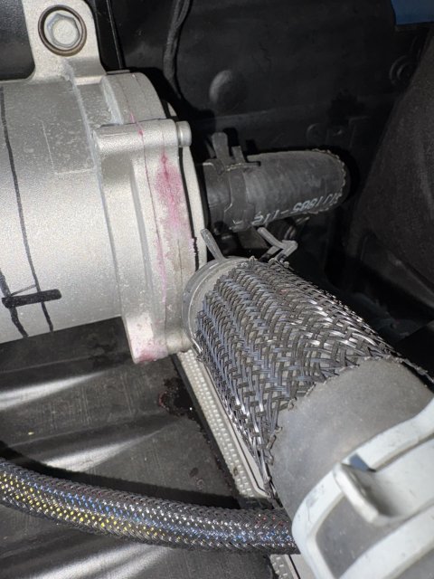

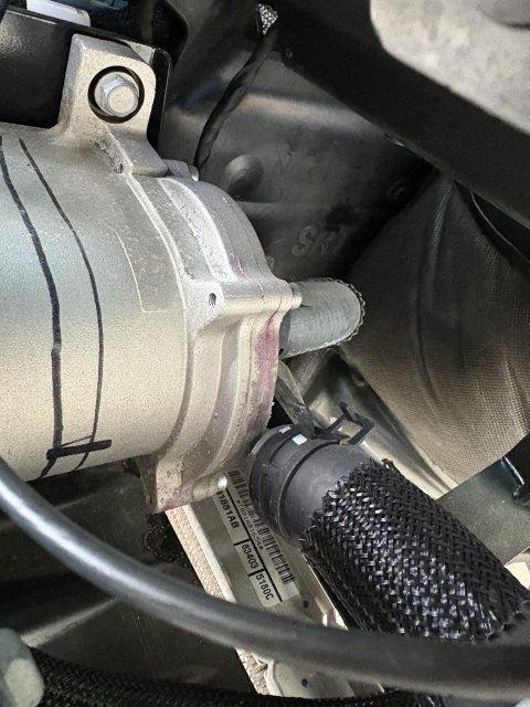

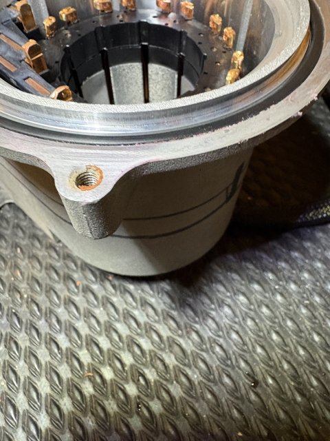

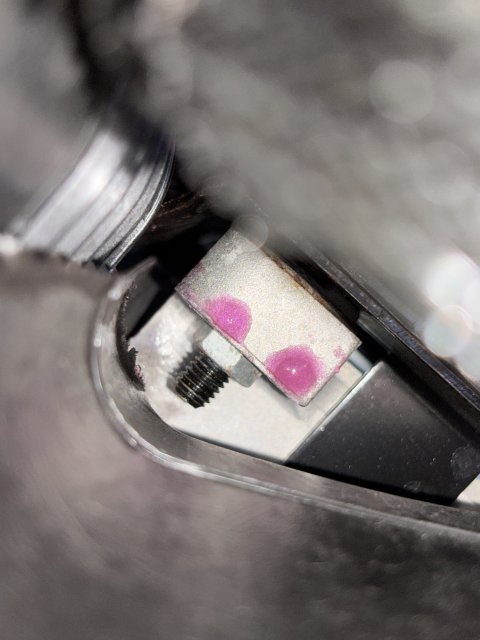

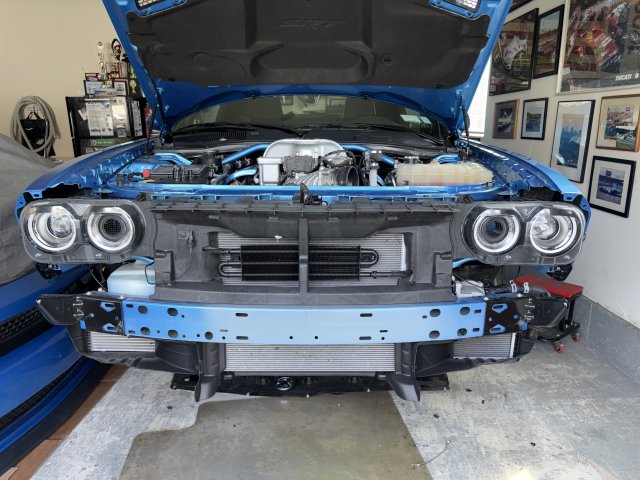

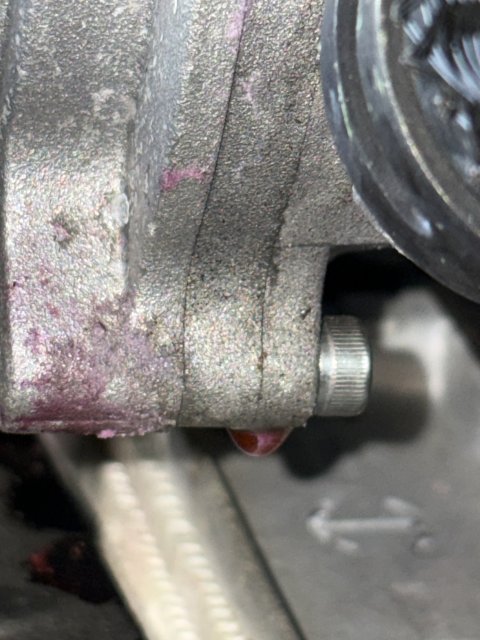

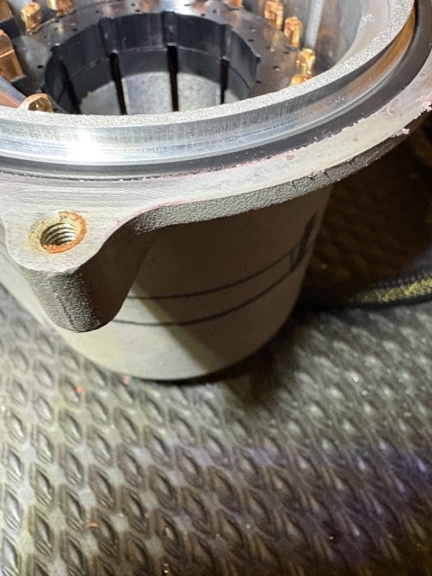

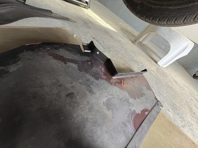

Latest. Front end off, easier than I thought, relief. Intercooler pump has 2 half’s with seepage. I tried torquing down the bolts holding it together. They didn’t move. Anybody deal with this???

There doesn’t appear to have a gasket between the 1/2’s. Wtf?
4,896
11,790
Wash it all down and start fresh. Find the highest leak.

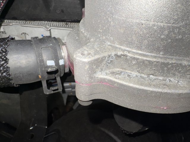

The O Ring appears to be a bit flatter on one side, maybe an inch long area.

Yes, agree, just replace the oring, it is most likely the culprit. McMaster is a GREAT source for them.

Tony I agree with the others on that O-ring and I'm sure that will fix it. If not then maybe another pump? Looks pretty easy with the bumper cover off. I've never removed mine and you say easy peasy?

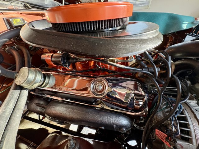

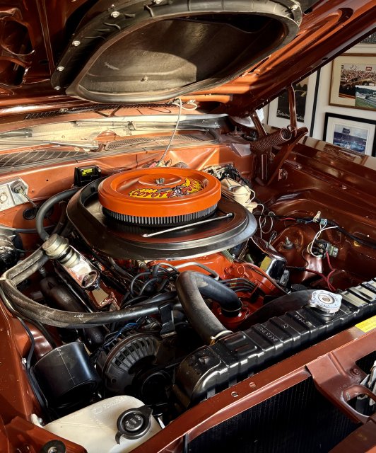

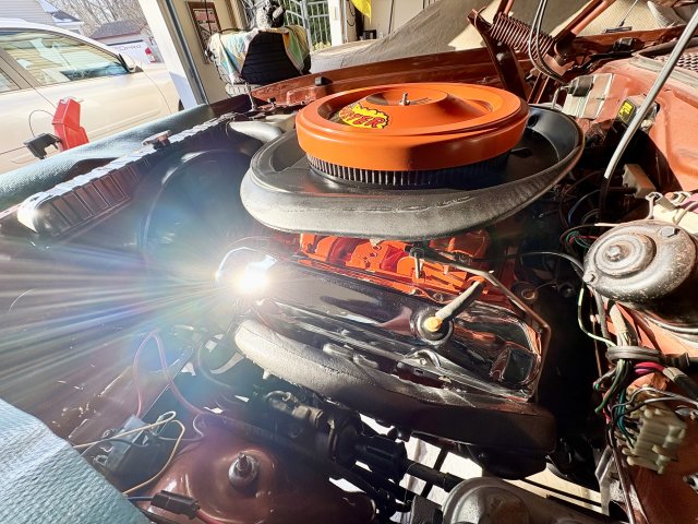

@Octanewide Good am Jeff, haven’t spoke in a while, hope all is well on your end. The bumper cover removal was not at all hard, just a pita with the clips, the rivet ones are single use. I’m always afraid of shitty gaps and chipping paint putting it all back together. I just finished an off season refresh of my Roadrunners engine compartment then had to get right into this, not knowing what I was getting into. Good thing I was fortunate to retire last April or none of this would be getting done! Talk soon, take care IMG_3606.jpeg IMG_3602.jpeg IMG_3601.jpeg IMG_3604.jpeg
