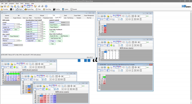

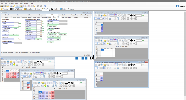

I did some more diggin on the hptuners forums, found an A8 Stock Tune. Here are the values from my 2015:
Here are the values from the 2018 A8:
And the diff:
The plan is when I get home to do a read, apply the values from the 2018 HC Challenger for the the Torque Reserve switch and all of the tables open in the screen shots. Then I plan to go to the local school parking lot while empty and see how it performs through logging. Looking forward for this to be enabled and usable at the track, would be cool a nice to have as I have grown quite fond of launch control.

Some interesting results from today's parking lot tests. I started out by doing a diff of the 2018 Hellcat A8 file and applying all column and row axis values to the following launch control tables:
[ECM] 47501 - Launch Control Torque Reserve (Slow Path)
[ECM] 9962 - Launch Control Fast Path Proportional Term
[ECM] 9959 - Launch Control Slow Path Minimum Error To Enable
[ECM] 9960 - Launch Control Slow Path Initial Torque Reduction
[ECM] 9961 - Launch Control Slow Path Initial Torque Reduction Multiplier
[ECM] 9957 - Launch Control Slow Path Proportional Term Multiplier
[ECM] 9958 - Launch Control Slow Path Integral Term

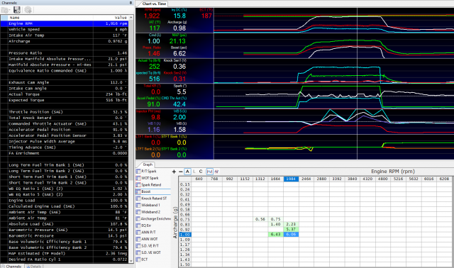

Left it at 2000 RPM for the first test, made a whopping 6PSI of boost... Started to spin. Also got scared shit less cause of the way the wide bands sensors were knocking around. Here is a screenshot:
I undid the work. Although I didn't spin in 1500 or 1750 rpms I realized that the row and column axis modifications might not be worth it for me they were also wildly off. So I decided to go a different route. Currently heading back to the spot, having a moment of genius.
