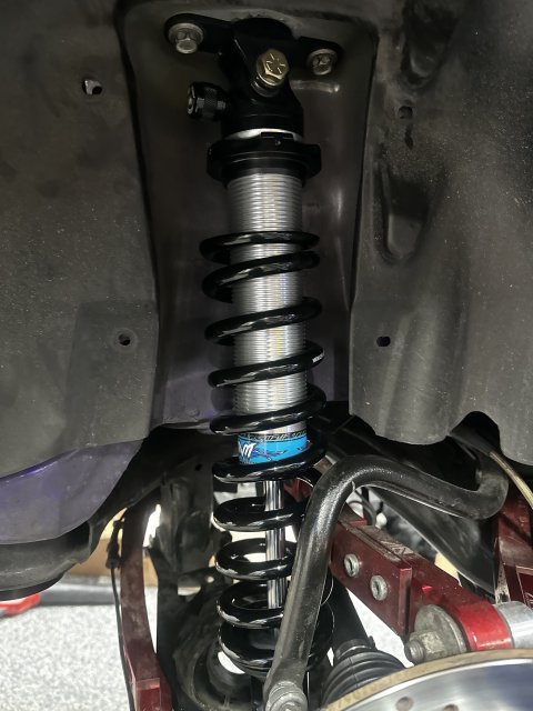

I like! All of the electronics are out of this car right? Wonder if I can disable the active suspension and switch to these
Yes shock delete engineering makes plug In adapters to keep light off
7,684
6,457
Ah no way really? Good to know. Let me know how these work after you dial them in
7,684
6,457
How much total weight did they shave off the car too? You remove the rear perch springs with these right?
Was about 30 pounds total front and rear yes you loose the rear springs. Going to be a bit I’m putting in a cage also and my 3.8 whipple

$600 for the sctiver dampener delete is insane. I wonder if you can just shut it off with Alfa
I could for 4
Yes you can. I totally forgot that’s what I did on my car once i switched out all for shocks.

Exactly the answer I was looking for Z, thanks for confirming!
It’s mislabeled in AlfaODB, I’ll look for it later tonight.
Ok maybe not tonight, I couldn’t find my notes on it and my car is already loaded up in the trailer for an upcoming trip
No worries! I’ll keep an eye out for the information though, would definitely like to see what needs to be changed. Thanks man!
