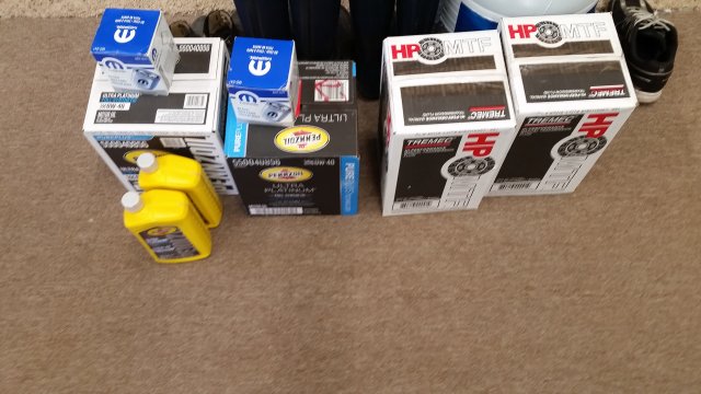

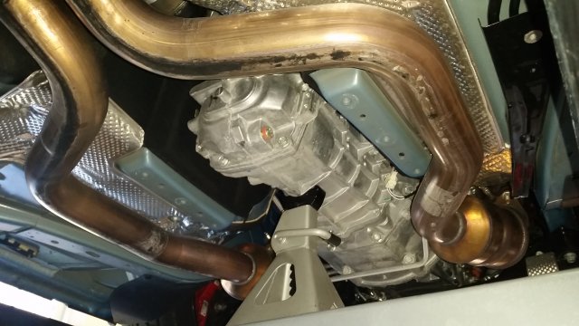

M6 here - replaced the factory ATF with the TREMEC high performance fluid. Smoother for sure. Recommend you take the cross member out unless you want to clean up a mess.
View attachment 107458 View attachment 107459
I decided on the Pennzoil Platinum ATF+4. I was thinking the rear diff oil would be easy but I can't make myself pull the trigger on the AMSOil severe duty. $60 just seems crazy for 2 quarts to me. Did u add the fluid thru the top or pump it thru?

I hear ya. Seems high performance lubricants are not inexpensive but the HC is worth every penny. Manually pumped by hand into the case fill port.
