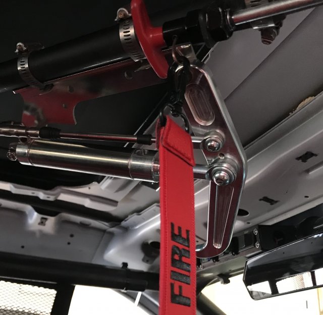

That was a good response by the track people! Unfortunately that’s not always the case. The possibility for a car destroy fire at this level is a real thing. I have a 10 lb Safecraft fire suppression system with four nozzles. Two are auto (heat activated). One in the trunk with the fuel tank and one in the rear interior behind the drivers seat. The other two are in the engine compartment over the headers on each side. Those are manually activated by pulling a T-handle. Plus…. A hand held where I can get to it from the driver side. Obviously I’m scared of fire 😬 IMG_3571.jpeg IMG_3011.jpeg IMG_3825.jpeg IMG_4966.jpeg IMG_1934.jpeg

That was a good response by the track people! Unfortunately that’s not always the case. The possibility for a car destroy fire at this level is a real thing. I have a 10 lb Safecraft fire suppression system with four nozzles. Two are auto (heat activated). One in the trunk with the fuel tank and one in the rear interior behind the drivers seat. The other two are in the engine compartment over the headers on each side. Those are manually activated by pulling a T-handle. Plus…. A hand held where I can get to it from the driver side. Obviously I’m scared of fire 😬 View attachment 139930 View attachment 139931 View attachment 139933 View attachment 139934 View attachment 139935
I would add one more to cover trans tunnel. Otherwise your layout wouldn’t be that useful for suppression in a scenario like mine. More protection more better! I’ll be building out mine next.
