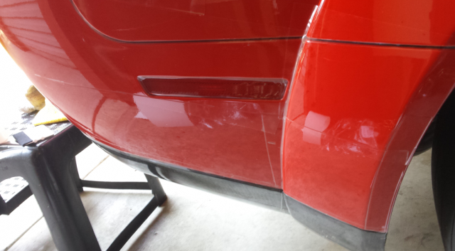

I leave it on
For multiple races

Great idea!
I see it comes in various widths. Is that 4" or 6" or ?
I purchase one roll of each.
6"×40' and a 4"x20'. I use the 4" for the black
Plastic.
I also purchase a soft blue micro fiber
Rag they sell to complete my order.
I'm getting better at installation.
You can hardly see the tape after
Its been washed and dried It really clings to
the car.
If it's been on awhile and it's cold out.
Heat it with a hair dryer it peels off like
Bananas.
