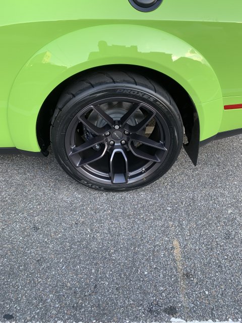

Great simple mod to stop that pesky non stop brake dust from the factory Brembo pads. Stopping feels great, break in was simple and now good to go. Cleaned up my wheels with a microfiber towel, gave them a coat of Nexgen ceramic spray and that was it. 3D4CE213-5FC8-41A0-AE91-1EFCEB86EBA3.jpeg 3D4CE213-5FC8-41A0-AE91-1EFCEB86EBA3.jpeg F1FB47A0-84B0-435F-84B7-F7CFB92D22F5.jpeg

This is on my to do list. I only 1/4 mile race my Redeye from time to time but the damn brembos pads dust terrible after only 100 miles or so. I heard you don't lose much if any stopping power from these. I don't road race, so if they fade a bit faster, that's okay by me. What's the break in procedure entail? I'm also considering hawk ceramic pads too, I've heard good things about those as well.
