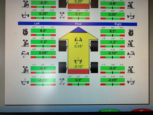

This is what was sent too me !
I forgot I am a little positive camber in the rear. I'm not sure if toe was adjusted or not
