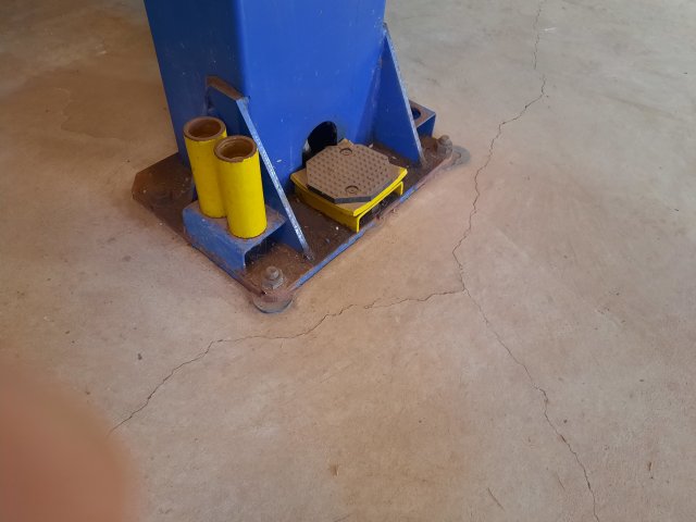

I just found out that my garage has a crack down the middle of the concrete and unable to install a 2 post lift.
Thinking about buying a single post list. Anyone have any experience, knowledge or recommendations <which company to purchase from>?

if your concrete is 5 inch or more a few cracks shouldn`t stop from installing a 2 post.
are you talking about an air over hydraulic in ground piston style? I worked with those for years, as they wore out an started leaking oil just replaced with 2 post above ground. cracks or no cracks.

If the cracks are where the post have to go, you can have a good concrete guy cut out a 2 or 3 foot section and put in a reinforced pad. Your concrete may not be thick enough with out doing this anyway.
As for a single post hydraulic, have you priced them?
Just saw your last post, not the single post I thought you were talking about. After looking at it, not for me.
For what it is worth, I had a twin post and then had to change to a 4 post because my Chevy based motor home can't be lifted by a 2 post. The 4 post however obstructs access to so much under the vehicle. I prefer the 2 post for access to the entire underside of the car.

I agree with Deano..........if you only have 2" of concrete spend a bit of money an cut a nice area an pour a thicker pad, I think you would be much happier. I`m not sure I would want to even use that style on only 2 inches. ...............safety first!!!

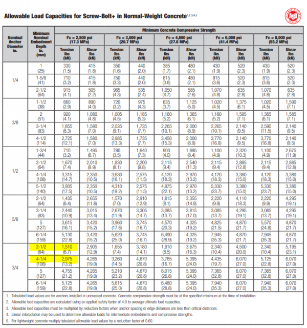

A crack in your concrete does not prevent you from anchoring into it. In fact the anchors these days are designed/tested for use in cracked concrete. While the concrete substrate does lose some strength, I think you'll find that the load values are more than acceptable. The only situation I would avoid entirely is if the spot you will be anchoring to is cracked to the point where it is starting to crumble. My recommendation is to use the DEWALT Screw-Bolt+ Anchor. You do not have to worry about edge distance with this anchor is it is not a wedge type anchor and it is approved for cracked concrete by the latest ICC building codes.
Your garage slab is a minimum of 4" thick by code, reinforced by rebar or at minimum reinforced by wire mesh, and is 2,500 psi at minimum. Given those conditions if you use a 3/4" diameter x 2-1/2" long Screw-Bolt+ you'll have 1,150 lbs load capacity in tension from a single bolt, meaning pulling out directly up from direction it was installed. This is the force we are most concerned about here, the shear load is much higher but also not as relevant. There are 4 anchor points per post probably, so at minimum using the 3/4" diameter x 2-1/2" long Screw-Bolt+ you will have a load capacity of over 6,000 lbs at one post. I personally would use the 3/4" diameter x 4-1/4" long Screw-Bolt+ if you can.
You might wonder how I know this and why this is valid. I have worked in the construction industry for almost 15 years selling these products, more specifically now for DEWALT.
http://anchors.dewalt.com/anchors/p...rs/screw-boltplus/screw-boltplus_hex_head.php
http://anchors.dewalt.com/anchors/_documents/uploads/dw_screwbolt_e_techpage.pdf?1610289085

The load values I posted above are "Allowable" which means they have a built in safety factor for them and in uncracked concrete. If you click on the lick with load tables there are "Ultimate" load values which are much higher. The values are basically the upper limits of failure with no safety factor involved. For reference the ultimate load capacity given the same conditions of 3/4" diameter x 2-1/2" long Screw-Bolt+ is over 24,000 lbs.
I would avoid drilling/installing the anchors directly into the path of a crack just to be clear, but a crack in your garage shouldn't be a huge deal.

That is why I love this dang forum!! @greasy killed it. Thank you brother!!! I will take some pictures of the concrete and post them.
Btw, my house is 22 years old and HOPE to pray I have 4" concreate. But we will drill and verify today.
