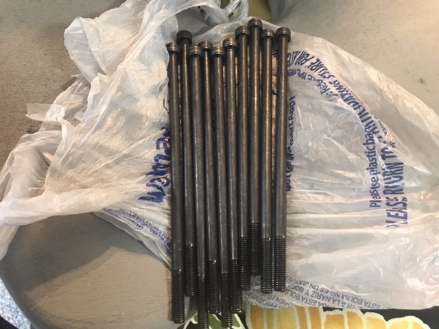

A set of brand new bolts for Hellcat SC with spacers installed. Free to a good home but buyer pays shipping. PM me for any details.
These came with kit for my Redeye but I’m installing custom bolts. 9B92BDA2-F83F-4092-BA94-7D94ED07E8AC.jpeg

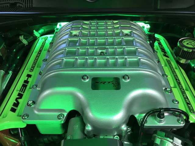

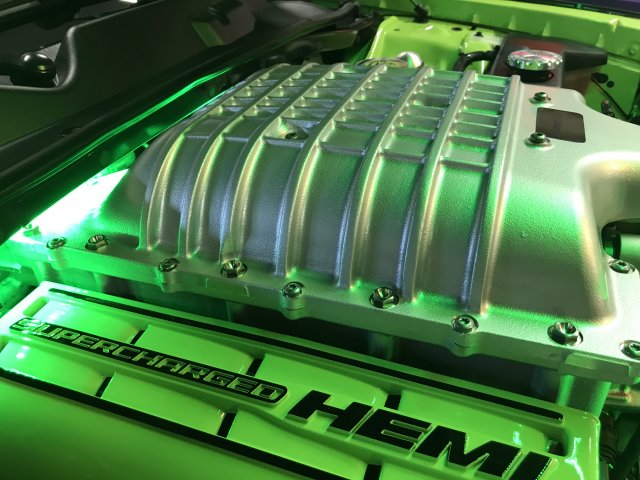

What do the custom bolts look like that your going to use?
Are they more like the OEM bolts?
4,679
24,285

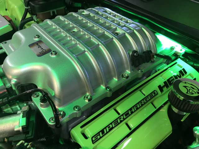

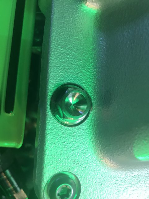

I posted pictures earlier but,
D32928F8-6D52-404A-9724-90BE922A0D07.jpeg 0C327749-9E74-4633-9F10-20FDA5E7A16F.jpeg 374638D6-C587-4CBF-99E2-2DBC9DE5813C.jpeg A3509B04-C2A8-4B85-9C98-D38B09F53AB7.jpeg

Nice, must have missed your original post, those are different and look a lot better then the ones you get with the spacers.
Who makes those?
I was trying to find ones that look more like the OEM bolts, but no luck.
Linked you to the original post. The new bolts are titanium. They are awesome.
@Paladin06 can you link me to the original as well. I knew figured they had to be titanium with that dimple, I was trying to find an option to the bolts that come with and the last time I was researching found the titanium ones but I believe they had to be made since it was custom length?
They look good!

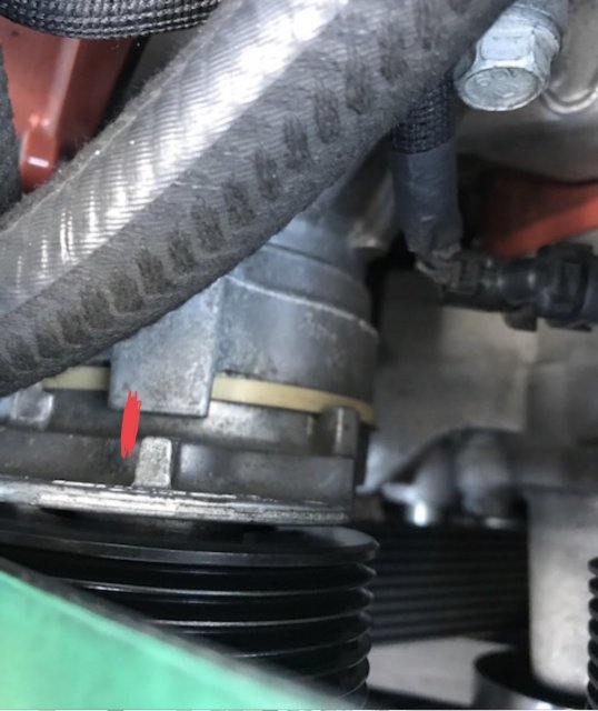

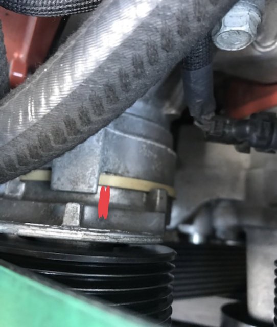

@Paladin06 just curious did you use the stock belt with the spacers? Some said the stock belt was fine. I guess the only way to really verify is put it on and see where pointer lines up on the tensioner.
4,679
24,285
Yes I did with no issues so far. The paint marks aligned before the installation. 1C64DE4A-B26B-458F-BF76-B2E874978960.jpeg

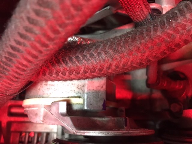

I think that is on the tight for my for my OCD, I went with a 1/4” bigger belt, 1st pic is where I was before the instal, 2nd pic after the install and before installing next size up bigger belt.
With the 1/4” bigger belt i lucked out, it put me right in the middle.

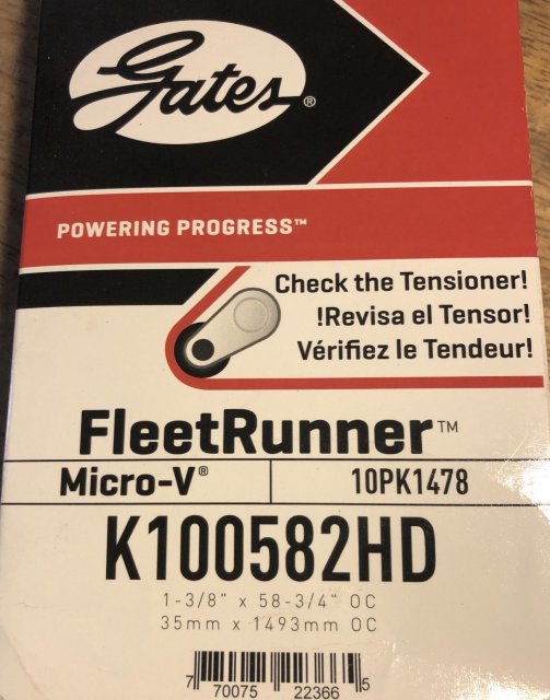

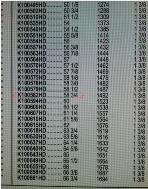

What part number gates belt did you go with?

Went with K100582HD.
7CAF20DA-3042-4569-BF31-6A6AB74C9F2E.jpeg A18F080D-BECD-4EF9-B2AB-A569E73FA471.jpeg

Those look real nice , I guess those are not cheap ?... did you go with the same length as the FI kit bolts ?... or a little longer ?
Actually they are just a bit longer.
