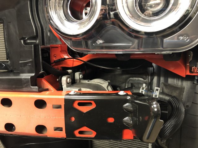

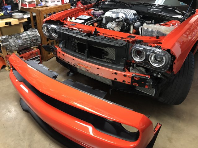

Already upgraded to emp rear trunk kit. Mechanic left stock motor in. I want it out.
3,568
8,407
Easiest way is take the front cover off, you end up taking bunch less apart doing it that way. Cover only takes about 45 minutes to remove and then the pump is right there 4 bolts and it’s out.
What you plan on doing with the removed pump? Its a spare part I don’t have and would be interested in purchasing it if you want to liquidate it please keep me in mind.
