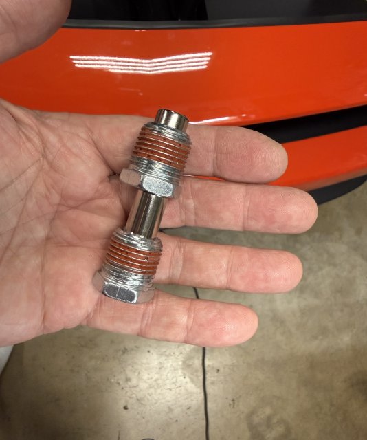

...tranny was more expensive as it is sealed with a removable panel/cover that has the filter built into it that they replace when they do this...
Most 8HP have a Filtran (filter built into pan) but the hellcat specific 8HP90's do NOT. you CAN get a service kit that includes a new filter, gasket, fill/drain plug (forget which or if it's both) and all new pan bolts. I have one in my garage and can grab the part number tomorrow...

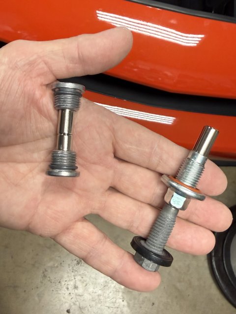

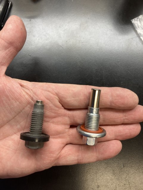

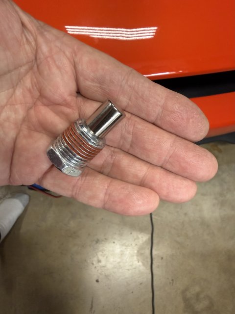

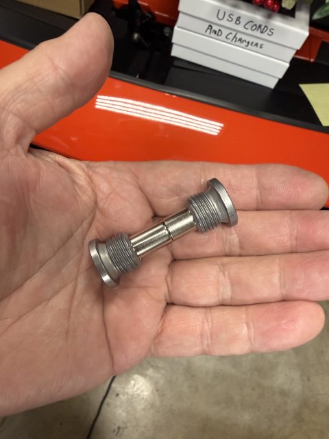

There's your A8 trans service package for Hellcat 8HP90's - includes BOTH plugs, pan bolts, new gasket and fresh filter.
I haven't searched for a while so I do not know if that part number has been superseded. Looking into that now.
