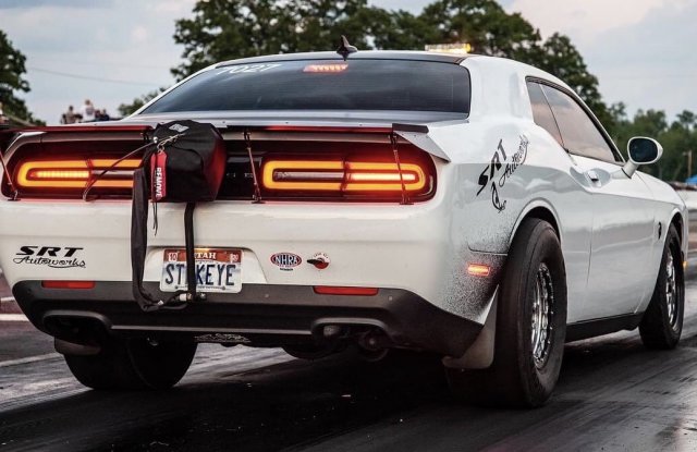

I have your answers lol. I have the 15x10 Billet Specialty’s WinLites. Very light and beautifully made wheel. For traction, the Radial Pros are better than the ET-R’s. Softer rubber compound and sidewall that likes low air pressure better than the ET. They won’t last as long. Still very stable down the track. I’m running the 315 (30” tall) but that requires some interior wheel well mod in one spot because that back space keeps the tire as far in as possible. It’s going to stick out the least on a standard body. I recently ordered a backup set with tires mounted and balanced from Carlyle. They were $2200 shipped. It’s been 6 weeks and I don’t have them yet. These things will put your 1000 hp on the track. 1.26 sixty for me, and this is the same tire that ZHT is running 8.3’s on with 1.21 sixty’s. As it turns out.... I’m not going to use them as I’m going to the DragPak rear and that requires a 4” back space wheel. I will be looking to sell those unused. 306A1AB2-3FB3-488B-BC38-96874BB99B71.jpeg 2A6CCBF2-3E2C-4370-94D3-9D55A35ECBB1.jpeg

I have your answers lol. I have the 15x10 Billet Specialty’s WinLites. Very light and beautifully made wheel. For traction, the Radial Pros are better than the ET-R’s. Softer rubber compound and sidewall that likes low air pressure better than the ET. They won’t last as long. Still very stable down the track. I’m running the 315 (30” tall) but that requires some interior wheel well mod in one spot because that back space keeps the tire as far in as possible. It’s going to stick out the least on a standard body. I recently ordered a backup set with tires mounted and balanced from Carlyle. They were $2200 shipped. It’s been 6 weeks and I don’t have them yet. These things will put your 1000 hp on the track. 1.26 sixty for me, and this is the same tire that ZHT is running 8.3’s on with 1.21 sixty’s. As it turns out.... I’m not going to use them as I’m going to the DragPak rear and that requires a 4” back space wheel. I will be looking to sell those unused. View attachment 26169 View attachment 26170
thanks Marc good info...... so the tires, wheel combo on your car now are the same as what you ordered or something different ?? if the pics show different from what you ordered an still waiting for, what`s the difference?
you said about wheel well mod, I assume your talking about that dimble that protrudes out from the flat area. I`ve seen some videos on that.
I ordered a second identical set of what I have on the car now. If you go to a race with a set that are worn but still have some passes left, when you hit the wear bars you need to put a new set on to make sure it hooks in that final round. A second set in the trailer, mounted and ready to go is the way to make sure you get to the end of the race. The Radial Pro’s are good down to the wear bars. At that point the hook goes away. I don’t want to pull a set of tires that still have 5 or 6 passes on them In order to get thru a race, so the second set is needed. I had already ordered this second set when some things came together and I ended up making the decision to go in the direction that is going to require a different wheel.

assuming this is the spot that needs a massage, the long skinny piece. IMG_20201004_133334908[3055].jpg

That and the area below on my car with the 315/60-15. That area below the rib where you can see the spot welds. I cut that with couple vertical cuts and beat that lip in and over. I don’t have a real good picture but you can see it in this picture looking up to show the tire clearance. 628941F2-0B61-4554-A812-C121DCE844C6.jpeg
