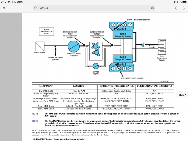

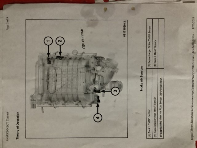

Thanks, I hadn’t seen that diagram.
However, I’m still not sure which of the 4 sensors the code is for... looking up the DTC, it calls out the intermediate TMAP sensor (#2 above). The ‘bank 1’ sensor is called out as #1 in the diagram above. And the Dodge service manual refers to #4 above as the ‘bank 1’ sensor.
I’m so confused...
I’m so confused...

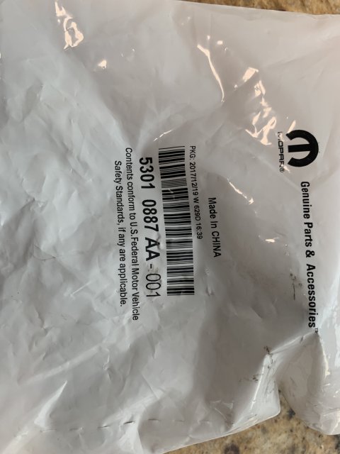

Demon sensor part number, dont know if it matches 18+ sensors.

Found this which appears to confirm its the intermediate TMAP. I’ve already got one inbound, so may just replace and see if that takes care of it for now.
