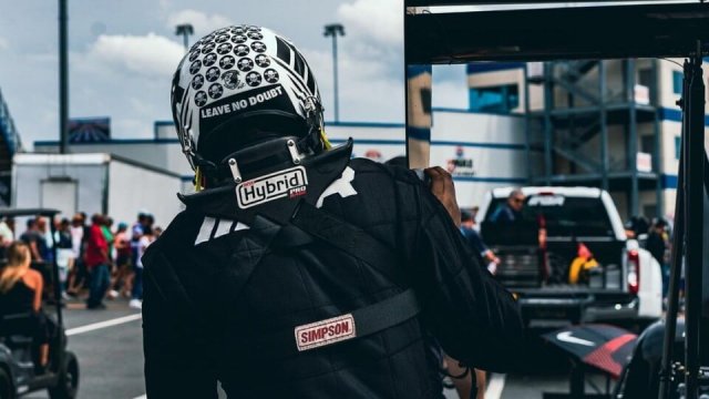

Kinda weird that they even bothered with the et part of that. 150 mph pretty much covers the concern and a car running 150 isn’t even close to a 7.49. The chute requirement doesn’t have any et attached so…. 🫤. I use one of the Simpson Hybrids and it does a excellent job of controlling helmet movement without banging into the helmet like the Hans. Another factor in protecting you neck is the weight of the helmet. Get the lightest one you can afford. A9743EED-4C6A-4B8C-96B4-56260C24465B.jpeg

I’ve used the Hans for some time. I switched to the Simpson for a couple reasons. If you look at the Hans, it sticks up behind the helmet with tethers that are higher than the Simpson. My helmet was always banging up against the device and it was annoying. I was always aware that it was there. Also some reports that the top part of the Hans can get hung up on anything overhead when trying to get out in the event of a crash/fire. The Simpson does a better job of limiting the movement of the helmet in all directions than the Hans and the strap on design is more comfortable when on.

I've used only HANS, starting with the original design, and currently have a newer, lighter version. Took a little getting used to at first, especially competing in a "finish line driving" class. The original version definitely limited the ability to turn your head, the newer versions greatly improved that with the ability to slide a little. I personally would never race a fast car without it or a similar device. In the interest of fair reporting, the NHRA often yields a heavy hand in rulemaking, with some things challenging logic and sound reasoning, but this is one area I will never complain about, even though it adds more cost to racing. These things have saved numerous lives from basal skull fracture.
