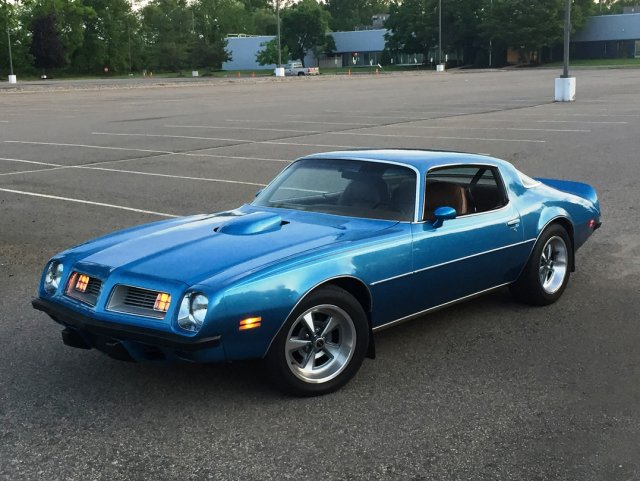

I think my world record battery life award goes to the AC/Delco battery in my grandmother's 1975 Firebird. That battery has been in that car and starting it every year since 1995! It's insane. It helps that the car has nothing to drain it from a trace charge, like an analog clock, but still. That's nuts. It's probably my Gramma Rose looking out for us (and her old car: she bought it new in '75). :)
Sealed battery? If not, were you/she using distilled water? Maybe the NJ tap water had some extra zip in it! ;)

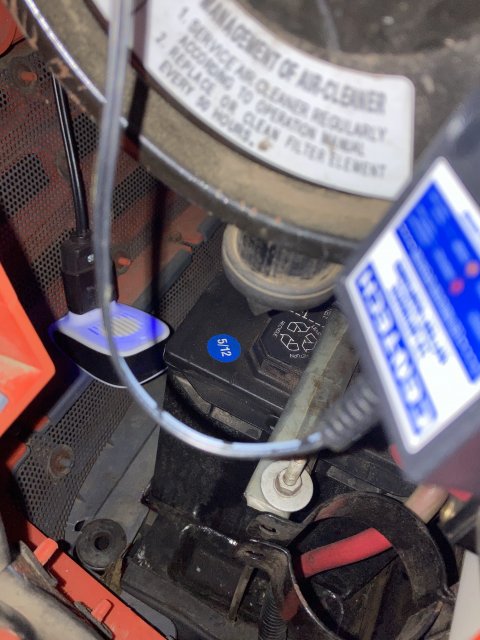

I just started my Bobcat today after sitting all winter with the HF float charger on the cheapest WM battery I could buy in April 2017. Fired right up. Damn that cheap HF crap!!! ;)

My record is 24 years on a set of Optimas.
It probably helped that they were always on a Canadus desulfator, and on a BatteryMINDer maintainer when parked, or a solar panel when out and about in the sticks.
