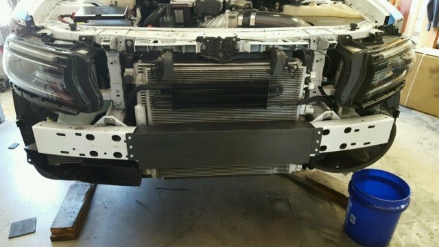

-Killer Chiller location doesn't look optimal/off IMO. Installer said he put it there for cooling - Requested in the crash beam or under the light. I think it's blocking airflow, what do you guys with kits installed think? Need to move it?

With that said, that KC core doesn't need to see any airflow on it. In fact, it's blocking some airflow to the a/c condenser which is a critical piece of proper a/c (and subsequently killer chiller) operation. I have my KC installed where my auxiliary heat exchanger used to be on the driver side. I also bypassed the primary as all it does is fight the KC when it's setup properly. The KC has the ability to drop I/C fluid temps far below ambient and all the primary heat exchange will do is heat it back up.

The installer wants to leave the killer chiller in front of the A/C condenser for airflow and to keep hoses facing down per Joe's instructions @ Kincaid.
I sent pictures of two other cars, one with the chiller installed under the driver light and another where the new coolant box is located now, so that's off the table. Shop doesn't want to put it under the light since hoses will be oriented sideways. Thinking cutting into the crash beam is the next best option. Anyone have ideas? Should have more pictures of the custom coolant tank setup later tonight.

Per Kincaid hoses can be side ways as long as Freon lines are on the bottom which they are mounted like I mounted mine under the DS headlight and hopper tank under the PS headlight. With insulation on them they fit on those spots snug and tight and the insulation let’s them float from vibration. No hoses, valves, nothing seen except for the insulated hoses in the bay to the back of the super charger.
