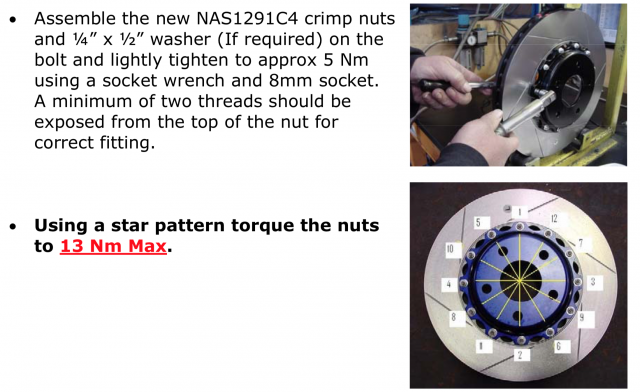

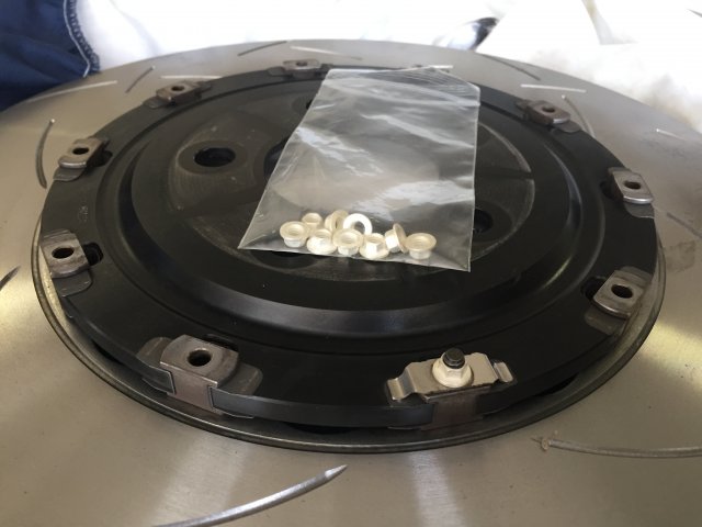

If you go DBA, here’s the nut torque info. It’s easy to do yourself. Just a little tedious and I used a bit of blue Loctite. They also send along new nuts. Nice thing about DBA is they’re non-directional so you can’t mess up which side you install them on.

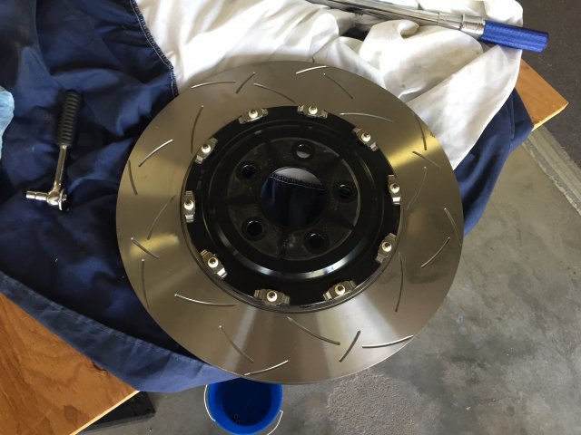

Once the hat was dry, I installed new spring clips and the cleaned up H-Bobbins.
Once complete, mount the hat, to the disk.
Use a small amount of thread lock, on the first few threads, of the bolts. Tighten them, in crosswise pattern, to 65 Inch Pounds. DO NOT OVERTIGHTEN THEM.
Now, you're finished and can re-mount, to the car.
Hope this helps.
Bob

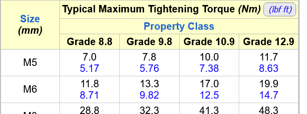

M6 is the size of course, which grade is critical, and you don't want to use 100% either.
CDT is currently using Grade 10.9 and recommending 120lb-in, but this is not directly applicable to the above information.

The torque info I used was supplied by DBA. 13 Nm = 115 inch/lb or 9.5 ft/lb.
