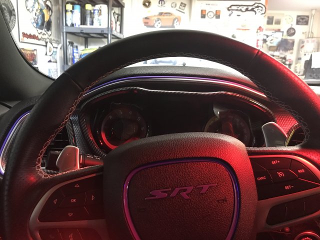

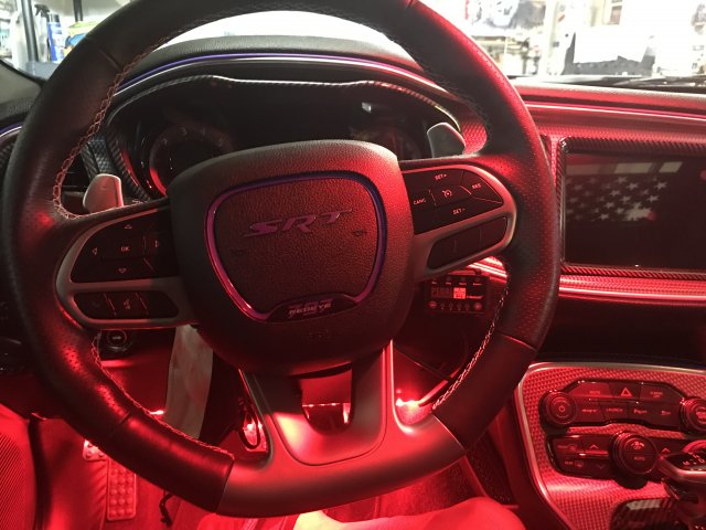

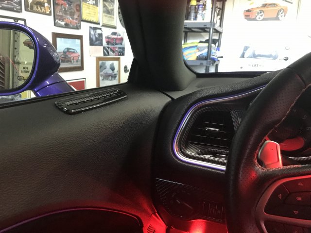

@Matt someone with an SRT we think alike. I really like my red LED’s in the interior. 8461F48A-B758-4BB4-89EF-B0AA71153631.jpeg 1FB8AE12-1DF4-438B-AB46-2FF8DBB43337.jpeg E3381AD1-BF0F-4F6C-976E-00050A9DB558.jpeg
