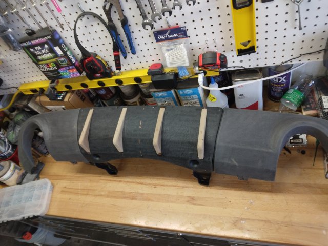

Here are some pics of the rear diffuser, font bumper insert and hood vent that I made from scratch. This was my first attempt at forged carbon, was ALOT of sanding, let me know what you think. 20230511_134611.jpg 20230424_174831.jpg 20230421_071754.jpg 20230528_095059.jpg

Wow matches the interior trim that’s really nice

C'mon, 1971. You start with billet carbon fiber, then forge it.

It’s chopped carbon fiber in resin. I have that trim (real carbon fiber, an option) in my Durango. It’s matte on the interior. This is a very good match

You can buy kits with raw carbon fiber (like this) not woven sheets

Thanks, that is what I used was different size chopped carbon and placed each and every piece in the resin, then sand for 2 days, then repeat. This is what I started with. 20230218_132334.jpg 20230405_133513.jpg

Amazing work. Factory piece covered in it or a mold?
