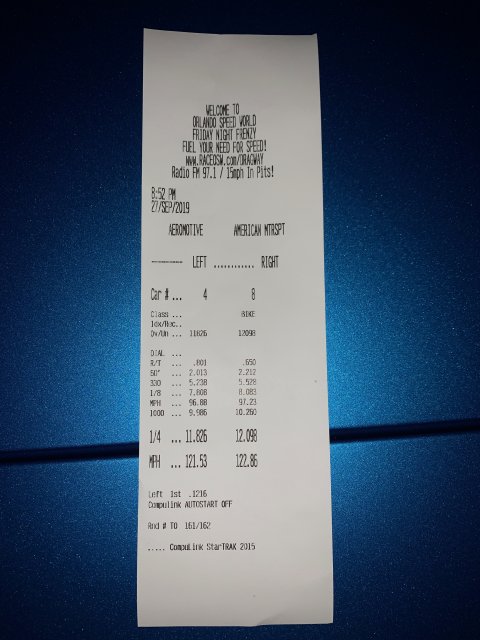

First off, the experience was incredibly fun! Having no idea what to really expect except from what I've read here and watching videos. I highly encourage anyone with one of these cars to go! A friend of mine has a WB Redeye and we met up at the track. We both arrived early, which is the key to having the time to prepare the car and yourself. But even more importantly, the track people having the patience to help you along when you don't quite know what to do. The people at Orlando Speed World were incredibly kind and patient.
On my very first attempt, I drove around the waterbox, backed up, then couldn't get to the line lock button on the screen because the backup camera had the "delay" option selected, so i pulled up slooooowly until the view of what was behind me went away. After that, the air pressure in the tires was too high, which lead to a massive burnout, I stopped, saw the pre-stage light lit, rolled up to staged, but I was actually staged with the back tires in the beams, The track guys thought that was hilarious for some reason.
After 3 not so great passes for me, and the Redeye getting better with every pass, we went out for the final time and actually had a drag race. When I released the brake, I don't know where he was because I was focused, but near the end I could see him next to me, and gaining. This was by far the best pass for me that night.

Best picture of the night.

Nice job , glad you had fun , that's what it's all about !
The more you go the faster you'll get.
If your on stock tires ?.... some DR's will help a lot.

Looks good! I guess you realize your 60’ time needs a little work. With DR’s your 60’ should be from the low 1.7 down to mid 1.5 range. That will greatly reduce your ET. It just takes practice but finding the right tire pressure, a good burnout and staging properly will help you get the best times out of your car. Have fun!

With some practice I hope to be able to do a good burnout, definitely stage properly, and leave correctly. The car was great! The driver needs work.

First time out, not bad.

I'm not knocking the 555R their good DR's but the M/T SS or R will do ya a little better at the track , I have found that 26psi is a good spot on good track prep.

Thanks, Mean Cat. I'll start at 26psi next time. I was wondering what pressure would be good. I was at 29psi. Also great advice on the tires.
