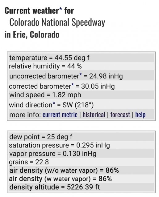

This morning's DA, obviously note the temperature.
: ( Screenshot_20211022-091735_Firefox.jpg
