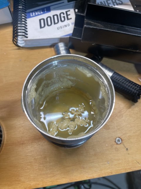

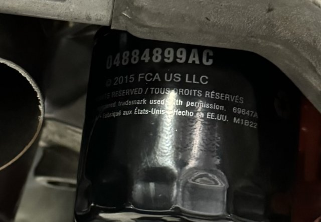

I don't agree with this at all. I'm a mid nine-ish car on a bad day. This is what is caught.
A proper catch can on a Hellcat goes a long long long way especially when driven.
