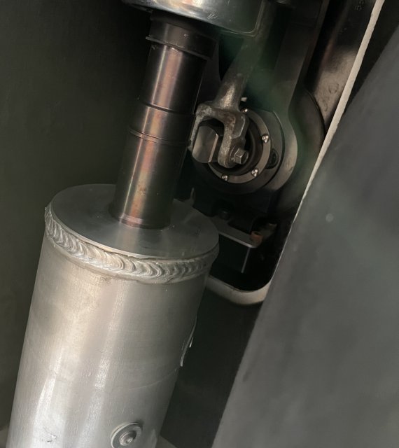

Here is how 4” fits. Not sure the clearance with wiles, looks like It’d be tight but might work. 9267C6D1-3474-4B49-A453-8DDCEE79968E.jpeg
All I know is these are a PITA for manual with a Barton😂
