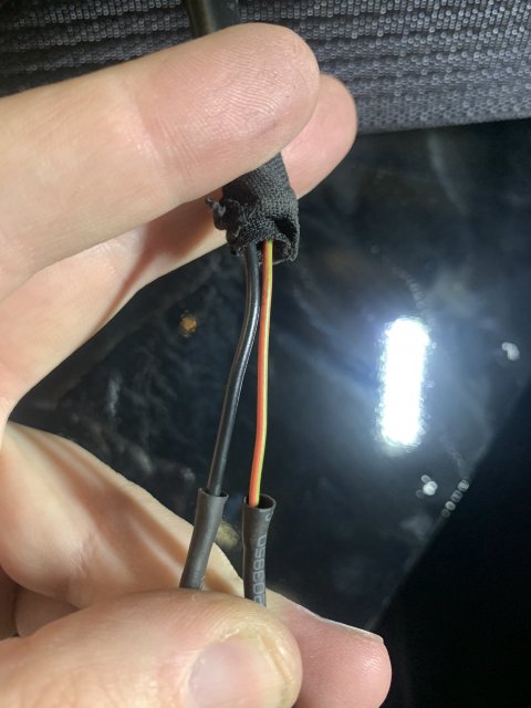

Bonus time! Found these two wires here just dangling, they were initially hooked up to the rear left speaker in the deck (amazing the car didn't catch on fire)... Anyone know what they are:
And shout out to @Diboblo for helping me navigate the wiring harness diagrams.

Nice work, brother.
The service manuals, available for download, have very good wiring diagrams, in them. I'll take a look and see if they lead to any revelations. Looked through all the rear deck speaker combos and didn't see any pairs of wires, with those color combos, for premium, or base systems.

Yeah went through the pages again and still scratching my head...

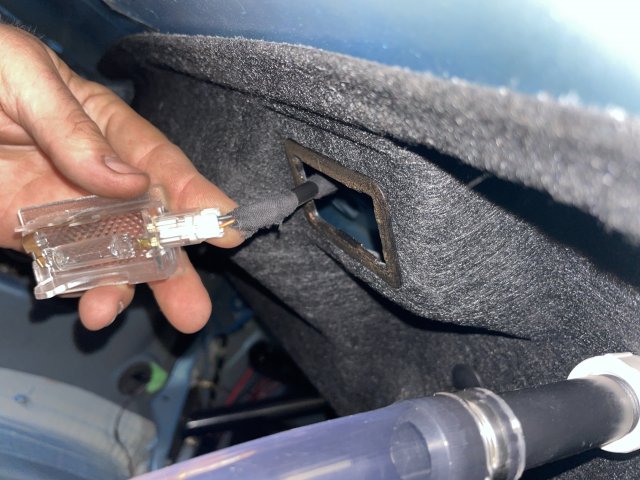

Today is the day. Today is the fooking day I finally found out what these wires are! Only almost a year later…
Are you ready?
The god damn trunk light that I don’t have…
Was in the friends shop while he was working on something. Asked him if we could trace the wires in his car. Since I don’t have the liner or light just going to get a nice led strip and attach it.
Are you ready?
Good find!
I have a spare light I can send you.
I also have led light strips, I can send.
Lemme know what color and I'll make it happen :)

Bob! I thought I sent a reply. I have to get the voltage from the wire as I don't think it is a true 12v dc but then again it has a dedicated ground., I think it is 5v from the PCM. I'll verify and then we can go from there. The trunk is pretty empty right now 🤫 but I think white would be good, need the sticky of the icky backing too. Most of the led strips I've purchased the backing has been poop. I'll get you a voltage reading tomorrow!

Bob! I thought I sent a reply. I have to get the voltage from the wire as I don't think it is a true 12v dc but then again it has a dedicated ground., I think it is 5v from the PCM. I'll verify and then we can go from there. The trunk is pretty empty right now but I think white would be good, need the sticky of the icky backing too. Most of the led strips I've purchased the backing has been poop. I'll get you a voltage reading tomorrow!
No problem, brother.
If it is the trunk courtesy light, it is 12v. That's what I tap into, for my Hellcatteunk light kit.
Either way, lemme know.
I apply 3M VHT foam tape, to the back of all my led strip kits. should work well for you.
