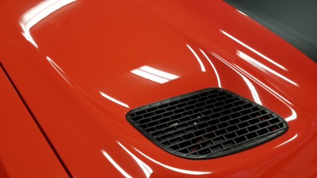

You guys know the car was professionally ceramic coated back in 2017 and the installer used Gtechniq Crystal Serum. It's SUPER slick, shiny, and practically nothing would stick to it. Dust would literally blow off as I drove down the road. It made the finish scratch resistant as well.
For the past 5 years I've mainly driven the car through a touchless car wash and blow it dry with a cordless blower. My goal is to avoid rubbing on the paint as much as possible. I probably use the touchless car was 3 or 4 times a year. In between I use Ech20 mixed 1:20 with water as a detail spray just to touch it up with a super soft micro fiber towel. The installer recommended this product as it would help preserve the ceramic coating. I might hand wash it 2 or 3 times a year using a foam cannon, two bucket wash method, and rinse with CR Spotless filtered water. This has all worked great.
After ChallengerFest I was giving GoManGo a good detail like I always do after the event getting it ready for summer cruises. Racing is over for me pretty much until fall, so this is one of the times I really clean it up good. I noticed as I was wiping off the few drips that remained after blowing it off that the microfiber towel wasn't gliding across the surfaced as smoothly as I was used to. I grabbed a plastic bag and did the "bag test" and DAMN the top of the car feels rough. Sides are still very slick, but all horizontal surfaces are rough.
I suspect pollen and other fallout has gotten on the ceramic to the point it's stuck on it somehow. I've been doing some reading and it doesn't sound like you're supposed to clay bar a ceramic finish. I did test a small spot by claying and sure enough, slick as glass afterward so that confirmed contaminants have gotten on the ceramic.
I've got an email off to Gtechniq to ask them how to solve it, but what are you guys doing with yours? To look at it you'd never know. It still looks super slick and shiny and water beads great, but it definitely needs something to bring that slick feel back. I'm wondering if I need to do a decontamination wash with some IronX fallout remover.

You can see from the picture I posted the finish "looks" great. It's just the feel.
