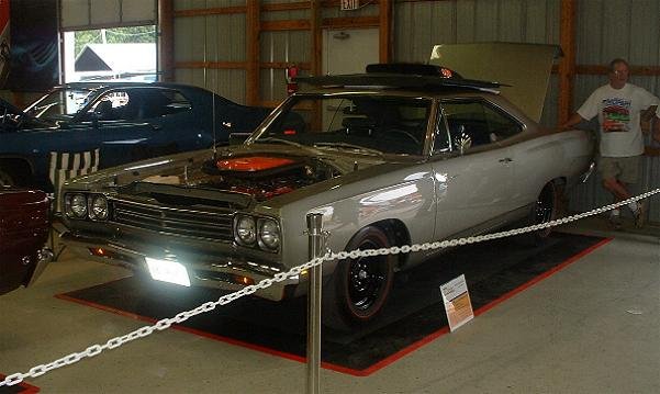

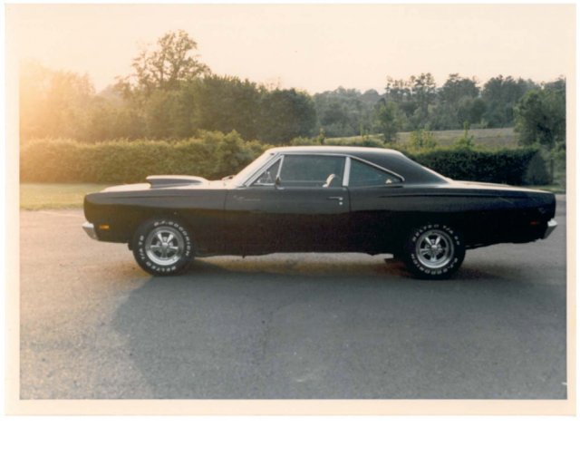

You have a nice RoadRunner @Old Mopar Guy. You don’t see many like it at the car shows. You can easily make sure that you could drive it anywhere. No improvement necessary! An A12 is more of a garage queen than anything. If you had the one in question, it could be a money pit like you said. Take it from experience. I raced and drove mine back in the 70’s, 80’s and 90’s. I enjoyed it but it became a trailer queen. Times have changed. Having a car like that is not the same anymore. I bought the black one in 1972 for $1,750 with 9,100 miles on it and kept it for 24 years. I had plenty of seat time in it. The silver one (platinum metallic) had 7,400 miles on it when I bought it in 2005. Needed almost zero real body work and had a perfect original interior except for headliner and carpet…but I did a $60,000 rotisserie resto on it, most of the work, including the motor, myself except for body and paint. Kept it for 12 years and had less than 200 miles seat time in it. Car shows got old and keeping a truck and trailer has its own issues. I still have a work in progress and not happy about it. Be happy.

@SilverBillet, you’re a lucky man having owned 2, never mind just one. That platinum metallic car is beautiful!!! Thanks for the complement on my ‘71. I can’t complain, of course, having the 2 toys, but with only a few more years, hopefully, until retirement, I thought it would be a fun resto project. I hear ‘ya about the car shows, when my RR was completed in late 2002 I did a bunch of local shows, got a bunch of trophy's, including Carlisle, but it got tiring, I do drive it though, so I don’t bother with the other bs. Plus I was riding a motorcycle then, and would much rather be on the bike all day than sitting around in a field. I would trade both cars for a wing car, but that’s a pipe dream at this point, they’ve gotten so out of reach!
