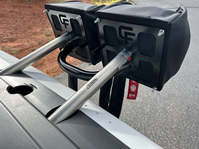

Carlin Fabrication sells a complete do it yourself package. image000000.jpeg IMG_7870.jpeg IMG_8019.jpeg IMG_8066.jpeg

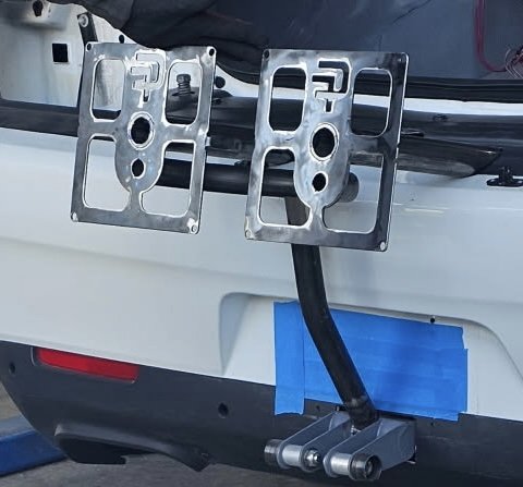

If you do a bolt together kit that you buy from motion you will most likely have to go right through the middle of the plate and you are mounting to the stock bumper. This you have to trim the bottom of the plate put you can 100 percent leave the plate in tact and just cover the hole with a license plate cover frame.

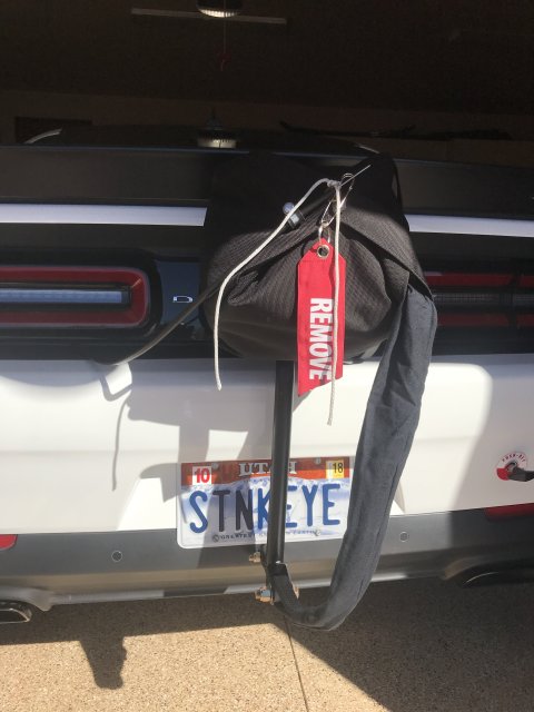

Back when I had the single chute done, it was simply bolted to the crash bumper using a plate with four bolts. At the time the shop that did it (SpeedTech) told me that a Chromoly tubing replacement for that bumper would not be any stronger than the extruded aluminum bar. Lighter but not stronger. I have deleted most of those old pictures but I do have one that shows where the chute attachment bar comes out thru the cover under the plate with that setup. I deployed at over 180 mph on a half mile no issues. IMG_8041.jpeg IMG_9980.jpeg IMG_8893.jpeg

Back when I had the single chute done, it was simply bolted to the crash bumper using a plate with four bolts. At the time the shop that did it (SpeedTech) told me that a Chromoly tubing replacement for that bumper would not be any stronger than the extruded aluminum bar. Lighter but not stronger. I have deleted most of those old pictures but I do have one that shows where the chute attachment bar comes out thru the cover under the plate with that setup. I deployed at over 180 mph on a half mile no issues. View attachment 170620 View attachment 170623 View attachment 170624

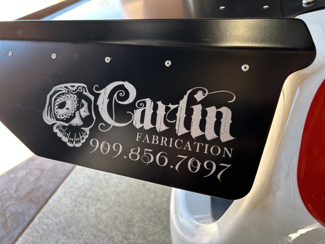

Jason at Carlin Fab makes a kit as well. I've been running it for 3 seasons.
