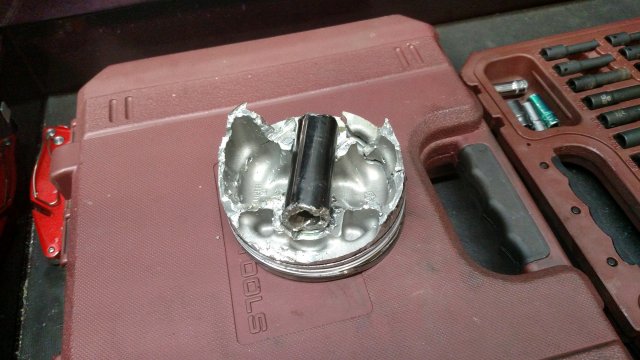

An engine is only as strong as its weakest part. In the case of the hellcat motor, it is the piston/connected rod as evidenced by the numerous engine failures in the wrist pin area.
No expecting the stock motor to live at double the HP or at crazy RPM, the point is to educate the Forum of the weak points so the same thing does not happen (e.g. learn from our engine failures). IMO, upgrade these parts and send it

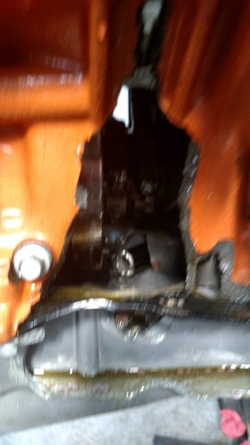

I am checking on that, I think it was the #2 or #4. As you stated, the piston was in the cylinder, the only damage to the motor (other the rod blowing out the block) was one slightly bent valves. I am looking for more photos of the piston in the block to determine which cylinder.

I'd be curious on how the temp. of that cylinder compares to the rest at high revs. Sure looks like a pattern evolving.
Me too. Difference in water passages?
