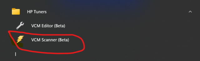

To log
open vcm scanner

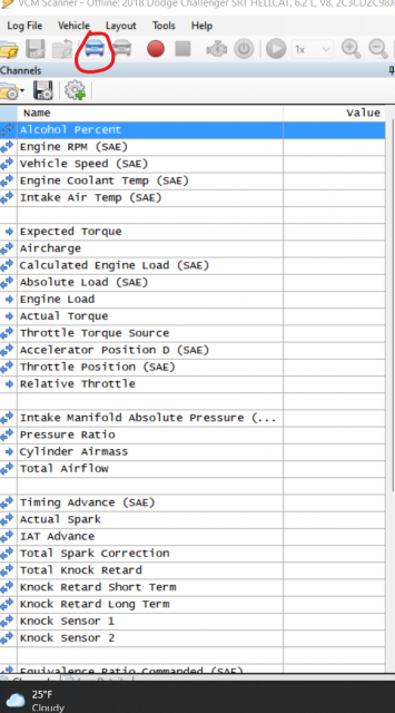

Under channels with the folder and gear open the hellcat.channel file
Connect to vehicle by hitting the little car
Red button to record and then the blue square to stop record
Click the save button to save then email to me
You must disconnect from vehicle before trying to write another tune after a datalog which is the other car button by the connect button. If you dont editor will just say cannot be found.
