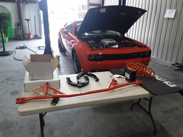

I and a couple others tested the R&D HHP Drag Springs. They are modeled after the Demon ones except they are black in color. They do help the transfer of weight during the launch. My 60ft also dropped to a 1.38. And a best of 1.36. I'm sure it will get even better once I get back in the groove next year. My originals have been replaced now to the new version.
With the weight of Hellcats building and strengthening the rear is always a good thing to do.

Without the AAD arms then the springs would be the way to go but the arms allow the tires to be square which make a bigger difference. The camber from the factory is all over so some cars would see different results with the springs

I run the Rear HHP demon springs. they are a good bit softer than stock. I left the front springs as they aren't much different. that accompanied by the AAD suspension, BMR cradle lockout and P4D front and rear diff brace. we will get an idea of how it will launch better this season. I was way over powering the 17's last year.

Really, its hard to say which would benefit the car more. Way too many factors, power levels, widebody vs narrowbody, both will dictate what the car actually needs. But for the Price, I think the HHP Springs are by far the Best Bang for the Buck.
