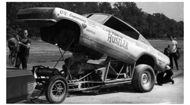

I can remember when funny cars were breaking into the 7’s. I think the Chi-Town Hustler was the first to do it consistently in 1967. Magazines called sevens The Twilight Zone.

Amazing when you see what these cars are capable of...compared to 1967...
