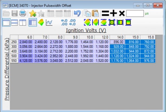

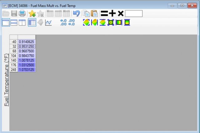

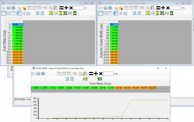

So here are the following tables and how I modified them. Fuel Mass vs Fuel Temp.
Inj. PW vs Igntion Vs Pressure Differential
(For this table the stock data ends at 16, I interpolated the values for 15.8 using linear interpolation.)

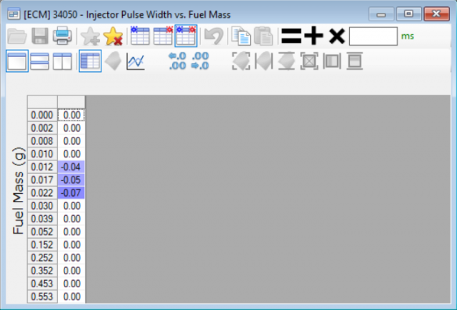

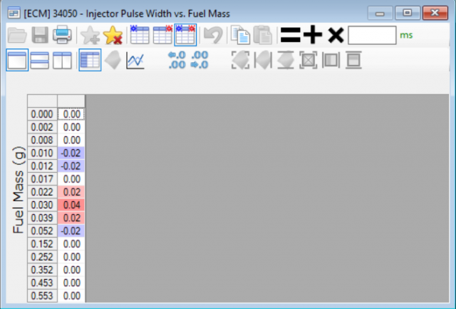

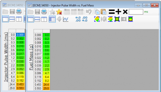

Then I modified the following tables, I changed the readings to grams (g) and (ms) after I was done with the ID data. These tables are inverse and need to be setup accordingly that way. These are the most important tables to get right from the start. The values you see here are not the stock data you will start with and I wouldn't recommend copying them and using them, my car != your car.

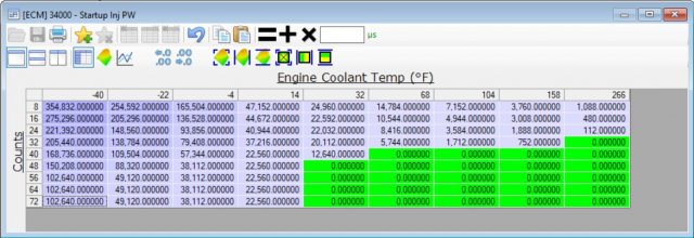

So the next two values are directly from the excel spreadsheet. The Startup Inj PW Scalar has a hard limit of 16 in the PCM no values above this will be accepted. Hasn't been an issue so far.
Then I adjusted the Start Inj PW with the data from the excel as well.

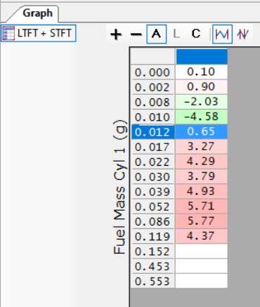

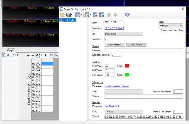

So with these injectors I have no idea where WOT will reside in the fuel mass vs LTFT + STFT histogram. Speaking of this is how I setup my histogram in VCM Scanner:
(keep in mind the photo above is not where you will start out with the stock data, I'll explain in a bit)
So to start I did some idle tuning. Exactly as that, started the car and waited two minutes to see where the fuel trims, after a minute or two I had some data for the down low ranges and adjusted as necessary. The delta for down low wasn't bad. Just had to remove some fuel as the injectors are "fat" with the plug n' play data. From revision 1 to revision 2 this is how much was removed:
When you update the Inj. PW vs Fuel Mass table you have to update the inverse table as well, they always have to be inverses. From here I started just driving around town. Nothing more than 3k in acceleration and nothing really crazy speed wise, no highway/wot pulls. From revisions 2 to revision 3, I had to add and remove some here and there:
Not a lot, the injector data is really good. Now I decided to do accelerations from 2k to 5k with paddle shifters holding gear to see where I am at. I also noticed the big jump from .052g to 0.152g and decided I wanted more granularity between those values so I setup the tables in the tune accordingly:
(this is why my histograms look the way they do). So with two revisions I have a fully driveable around town Hellcat with 1300XDS injectors installed. Of course there is plenty of data to still get. I need just more time. With the snow coming in and cold weather not cooperating for the tracks it just takes time. Maybe soon I'll be able to get to a dyno that my friend runs (a calibration dyno) and get better data for WOT. It was a fun experience and I want to get this 93 dialed in so I can then have some fun with E85. After revision 4 I started doing some more driving and now that I have a lot more granularity I think I overshot my values and run a little lean. But +/- 5% in either direction should be the goal. On the highway she crusies just fine.
