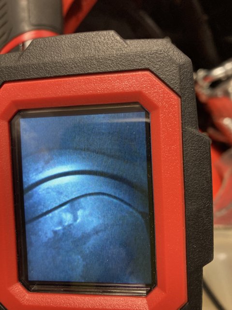

So after evaluating the data, the knock is not coming from the cylinders. On first drive it was smooth. Still going to replace the knock sensors but I’m glad plugs are done.
Stock healthy Hellcat cold compression is around 210 PSI, did you have the butterfly TB valve blocked wide open? My opinion from these numbers if TB was open is you may have cylinder sealing issues. Only way to know for sure is do a leak down test if it’s still apart, it’s the only way to know for sure what if anything is going on.
Plug removal, inspection, Leak Down test, bore scope, plugs back, ready to start up about 6 hours start to finish, that’s including pulling the cooling lines off the blower to get them out of the way as mine are insulated and fat and no getting by them. That’s doing each cylinder 2-3 times following the firing order round and round about 8 complete engine revolutions going the same direction always, don’t reverse direction if you go past TDC as you could loose ring seal in the piston grooves and get false low results. I just did this this past Saturday on mine, 3% leak down all cylinders, that’s with .026” ring gaps. Here is what plugs look like after 3000 miles on corn, F gasoline!!
View attachment 53982 View attachment 53983 View attachment 53984 View attachment 53985 View attachment 53986 View attachment 53987 View attachment 53988
210PSI! . I'm surprised. That's gotta be with the VVT being full advanced. With a a static 9.5:1 in the old days you'd get 160/165.

Those plugs are amazingly clean.
With that said, I do see a pattern amongst the different plugs, slight as it might be. Makes me wonder what's causing that...?
Break In, these plugs are the original start up plugs so they saw varying degree of blow by until rings sealed up. Plus their first 1000 miles of life was on gasoline so some show signs yet of its staining. The shading difference also comes from where the ground strap is verses the intake charge flow. Even though they are all indexed toward center cylinder and the intake valve some aren’t exactly facing the intake valve so they have some shading differences from that effect.
Agree about the plugs but I'm still skeptical about longer term wear on the E85 motors. They look pretty on tear down but they're almost too clean. It looks like a wash down to me. If that's what the plugs (and exhaust) look like, the cylinder walls have to be squeaky clean also. The squirters are oiling the walls but the E85 is washing them clean on every stroke. Plus if it contaminates the oil its also got to effect oil lubricity. And it's pouring into the motor with 35/40% more volume. I'd like to see the results from the lab analysis after Mike and Jay send theirs out. I want to do another tune on my car for E85 but that's one of the biggest reasons stopping me (and oh yea, the money. Lol).
I just mailed an oil sample to Blackstone yesterday to see just that, what’s in the oil. I change oil frequently, that oil had 800 miles on it, and use the best oil within price reasoning at frequency I change it, that was Amsoil 5W50 Signature Syhthetic, 70% more anti wear agents then most oils. If the tune is right wash down won’t be that bad. Another reason for using gapped rings verses gapless rings, the vacuum created during the intake stroke leaking through that gap pulls oil up in between the first and second ring to help keep oil on the top ring. Also the plateau cylinder hone spec
had a deep Rvk value Spec’d in it for a reason, deep valleys in the cylinder wall to hold oil for ethanol use. It was all part of the build plan :).
